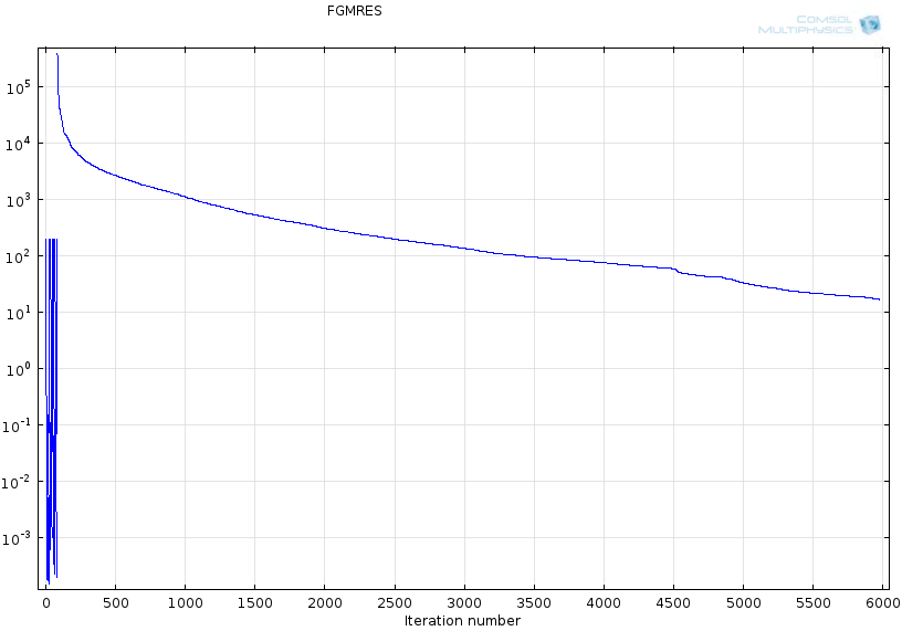

Dear all,
I am getting the convergence pattern presented in the figure attached for the simulation of magnetic and electric fields considering saturation of the metal (through a mu_r dependent of B). The simulation is fine until 95%, when the error becomes to decrease slowly. I am using a frequency domain study with stationary solver. There is a clue of what could be done to improve the solution?
Regards
2 Replies Last Post 21.03.2015, 10:45 GMT-4
Posted: 10 years ago 06.12.2014, 17:28 GMT-5
Problem solved! It was an initial guess issue.
Regards
Problem solved! It was an initial guess issue. Regards
