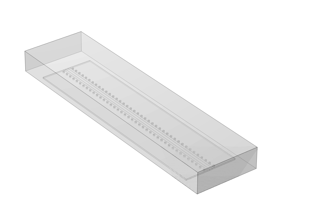

Hi! I am trying to add conductor losses to a simple coplanar waveguide model.

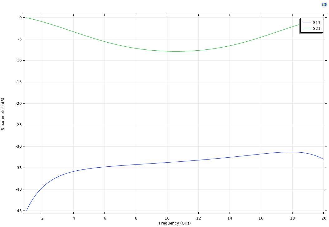

The model without losses (i.e. using PEC for all metals) works as expected (see attached "GCPWG_with_PEC_OK.mph").

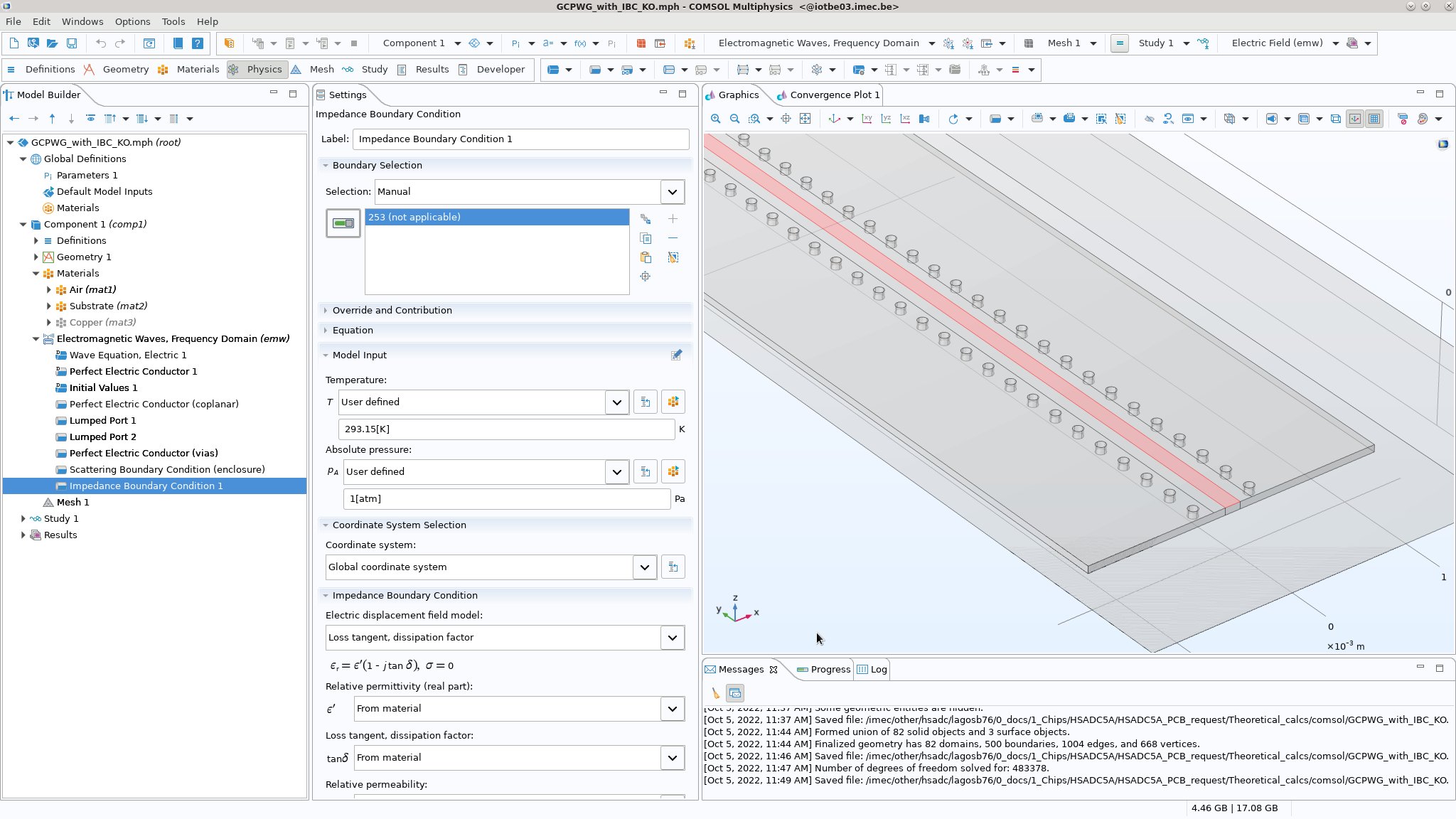

However, when I try to replace the PEC on the signal trace with a "Transition Boundary Condition" to model conductor losses, I get the infamous error "Uniform lumped port should be placed between two conductive boundaries" on my ports (see attached "GCPWG_with_TBC_KO.mph").
I tried some suggestions I found googling (e.g. adding a domain with the trace material, so that the TBC can "attach" to it and derive its properties), but I still cannot solve this problem.
