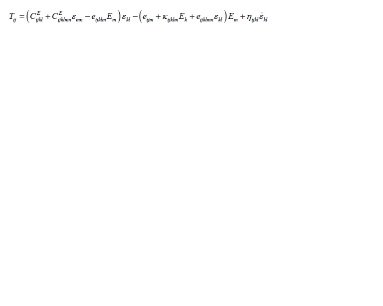

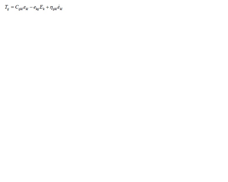

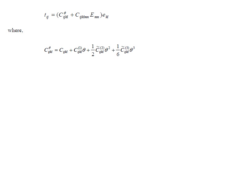

I have made a model of piezo resonator on base of piezoelectric interface. Now I try to take into account the nonlinearity.
So Comsol use formula1(attach) to calculate stress tensor from stain tensor. I want to use formula2 or formula3 to get nonlinearity and temperature dependence of model.
I cant find the way to change piezoelectric interface equations because there is no place to add new material properties as third order elastic constants (Cijklmn).
I tried to use physics builder to make my own piezoelectric interface, but the problem is I cant multiply elasticity matrix (6x6 matrix) by strain matrix (3x3 matrix). I know, that elasticity matrix is tensor 4th order (3x3x3x3) but Comsol use 6x6 matrix.
