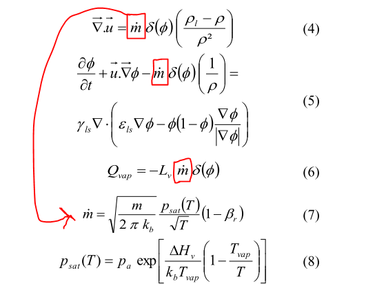

I am doing a simulation on laser keyhole welding and I am getting the following error: Attempt to evaluate real square root of negative number. - Function: sqrt Failed to evaluate variable. - Variable: comp1.ṁ (errors related to this ṁ variable: please see the attached figure. I have encircled this variable with red pen) I am trying to remove this error like last month. This "ṁ" variable (mass flow rate) has only one parameter in the square root which is Temperature (T) and I even put a boundary condition as T>Tvap. Smoothed the material properties. Refined the mesh. But no luck in solving this error. I request to all elite members to comment on it. I would be grateful to you. Thank you.

Thank you Alex for your input.
When I added eps inside the sqrt term, it made it run the simulation in the beggining but after a while, same error shown.
I think, my initial condition or BC has some problems. I am going to change some conditions and update you the results.
What are you working on ? I am modelling a laser keyhole weldings phenomenon.
Regards, Akash Meena
Thank you Alex for your input. When I added eps inside the sqrt term, it made it run the simulation in the beggining but after a while, same error shown. I think, my initial condition or BC has some problems. I am going to change some conditions and update you the results. What are you working on ? I am modelling a laser keyhole weldings phenomenon. Regards, Akash Meena
