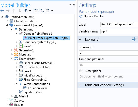

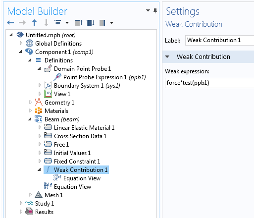

You cannot directly access the nodes.
You can however do something even more powerful: Apply a force at an arbitrary location irrespective of whether there is a node or not.
Do do that, you add a Domain Point Probe which measures the displacement at that point. You then add a weak contribution where you multiply the force with the variation of that displacement.
See the attached screenshots.
Henrik
