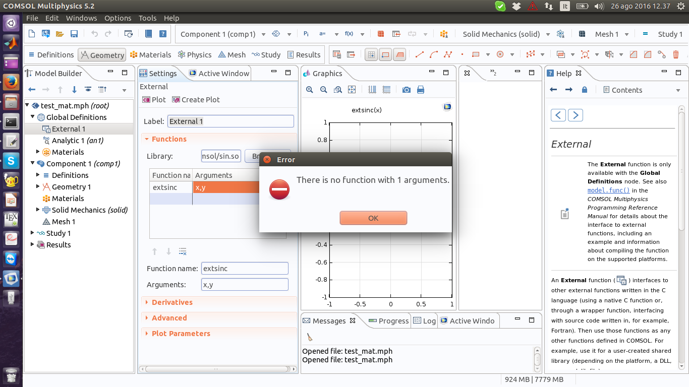

I'm quite new to Comsol and I'm trying to create a function of time and space which could be later used in my model. Unfortunately I cannot use a Matlab function because my version is too old so I'm trying to run an external c function. I could successfully run the case that is included in COMSOL Multiphysics
Programming Reference Manual with f=sin(x)/x and now I was trying to add a variable to the model and to plot the function.
When I call my function from Comsol I got the error "There is no function with 1 arguments", I tried to combine differently x and y but I always got the same message. I attach here the file with the function and the screenshot with the error.
Thanks to all for your help
