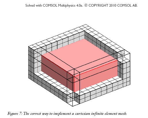

first I would advise to use a sphere with cylindrical PML and have it meshed as a few quad-sweep layers, or if you use the square cartesian cut your volume up into blocks such to use quad-sweep/block for the PML.

Thanks, can you please guide me how to cut cube volume into blocks. The dipole is excited as in tutorial and Idid use it with sphere and PML. I could not able to run on Cartesian PML.

just cut your cartesian PML section not into one hollow cube but into rectangular blocks, one in each corner (4x) one on each of the 4 edges, and one on each of the 4 main sides. In this way you can mesh it easily with blocks
Hi just cut your cartesian PML section not into one hollow cube but into rectangular blocks, one in each corner (4x) one on each of the 4 edges, and one on each of the 4 main sides. In this way you can mesh it easily with blocks -- Good luck Ivar
