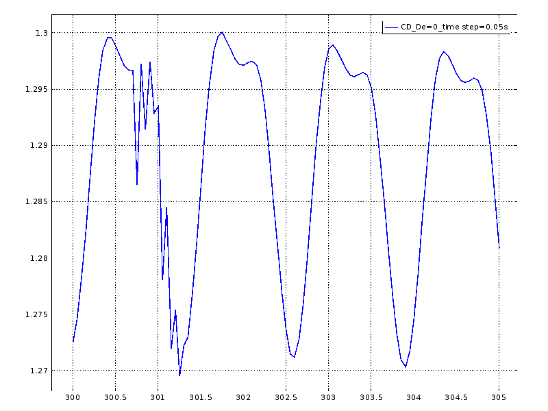

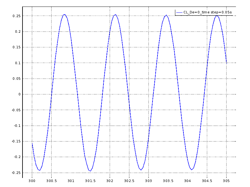

I got the attached results for lift and drag coefficient using "reacf()" function.
Please take a look at them.
I guess I should decrease the time step further.
Regards
Iman
Hi I got the attached results for lift and drag coefficient using "reacf()" function. Please take a look at them. I guess I should decrease the time step further. Regards Iman

I did that. I can also use Lift coefficient graph to find frequency.
So the time step is less than 1/20th of the period for (0.05s)!
I am running to case right now:
1- Using even smaller time step (0.025s)
2- Using finer mesh (almost two times in number of cells)
The CD graph is so erratic as you see in attachment. I don't know why?
Another problem is that the average Lift coefficient is not exactly zero. it seems the field is not perfectly symmetric, but as I checked It is totally symmetric .
Regards
Iman
Hi I did that. I can also use Lift coefficient graph to find frequency. So the time step is less than 1/20th of the period for (0.05s)! I am running to case right now: 1- Using even smaller time step (0.025s) 2- Using finer mesh (almost two times in number of cells) The CD graph is so erratic as you see in attachment. I don't know why? Another problem is that the average Lift coefficient is not exactly zero. it seems the field is not perfectly symmetric, but as I checked It is totally symmetric . Regards Iman
