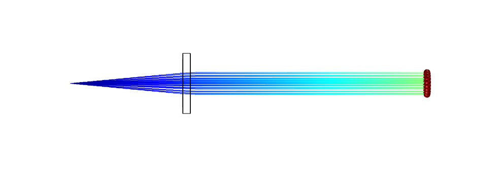

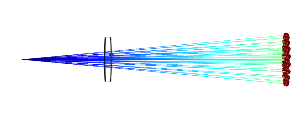

When I compute the study (in my geometry there are only a conical light source and a collimating lens) and plot the ray trajectories it's as if the lens isn't there. The light travels through and is not collimated at all. In attachment there are pictures of my ray tracing plot for a study with fixed refractive index (light is collimated) and for a study with frequency dependent refractive index (no collimation).

Hi, is there any way you can attach your model? It's difficult to say what the problem could be without it.
Dan
