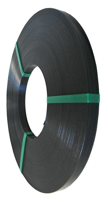

I would need to model a spiral coil as shown in the attachment. Does the multi-turn coil domain (MTCD) feature lend itself for the task?
The wire cross section is 0.5mm x 15mm, and the skin depth at operating frequency (60Hz) is about 8.5mm. Does MTCD take skin effect into account, and if yes, would the rectangular cross section cause problems in this sense? Or is the skin effect even significant, when the smaller dimension is less than skin depth?
