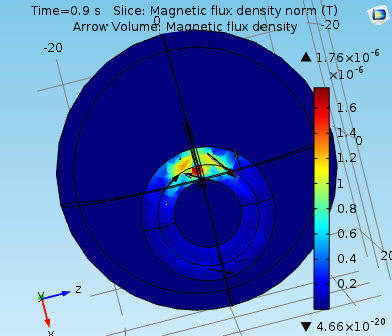

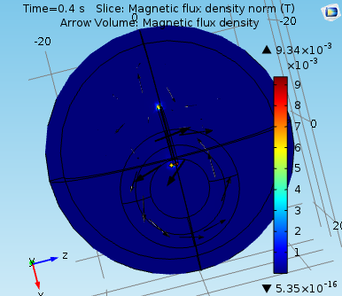

External cir Time Dependent study
Hi, my first go at constructing a time dependent study I set up a multi turn helix using U Vs. I excitation, around a toroid core, it worked in stationary study, but depending on if it's a voltage or current excitation it produces some weird results in Time dependent study. Can anyone explain what I'm doing wrong or what the results even mean? One strange thing is if I set the frequency to 1 Hz and step through the core has the most colour in it at the zero crossings, like at time 0.5s. Very strange.
