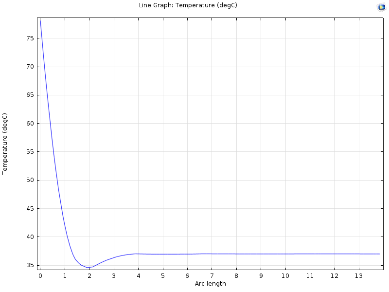

I am modeling the temperature distribution inside a layer of biological tissue. The geomtry is a cube. I put a temperature BC of 78°C on one of the face and a temperaure BC of 37°C on the opposite face. The others face are insulated. I am using the mode BIotHeat equation to model the heat removing by the blood circulation, so I put 37°C to the blood too.
I am writing this post because I think my temperature profile is wrong, indeed I obtain a minimum temperature inferior to 37°C inside the cube and it is physically impossible! The temperature inside the cube should be between 78°C and 37°C and the minimum 37°C. But I remarked that the problem disappear when I use Stationnary equation form in the tab Heat Transfer in Solids. I put in attachment the temperature profile of the cube.
It would be great if somebody could help me!!

As you state a temperature below 37 is not physical, I agree with this, but you have a curve that is typically an overshoot/ringing shape with a "small" error.
Those effects appear typically when you interpolate with higher orders over few spiky points, and/or that you run a FEM model without having respected a minimum mesh quality compliant with the physics/equations and BCs you set up.
You have a very steep gradient to the left, do you have enough mesh elements to resolve that temperature gradient ? are your mesh density, time stepping and the heat diffusivity alpha of your material set up to respect the minimum criteria for correct convergence ?
For the interpolation overshoot, you can set the plot "quality" such to use linear interpolation instead of the default second order, that might reduce the overshoot, but still check carefully your mesh, for diffusion equations (HT and chemistry) the correct resolving of the gradients of the dependent variables is crucial

Thank you a lot for your answer, it is very helpful! The problem was due to the time step too short. I change it and now I have a nice curve with convenient temperature!!

Still "time step too short" means you were hitting the
(alpha_th*Delta_time_step < h^2) limit
(h=average mesh size).
Often its worth to double check your results with and without Plotting smoothing, in "raw" mode see "Plot - Quality - Smoothing: none, Resolution: no-refinement"
