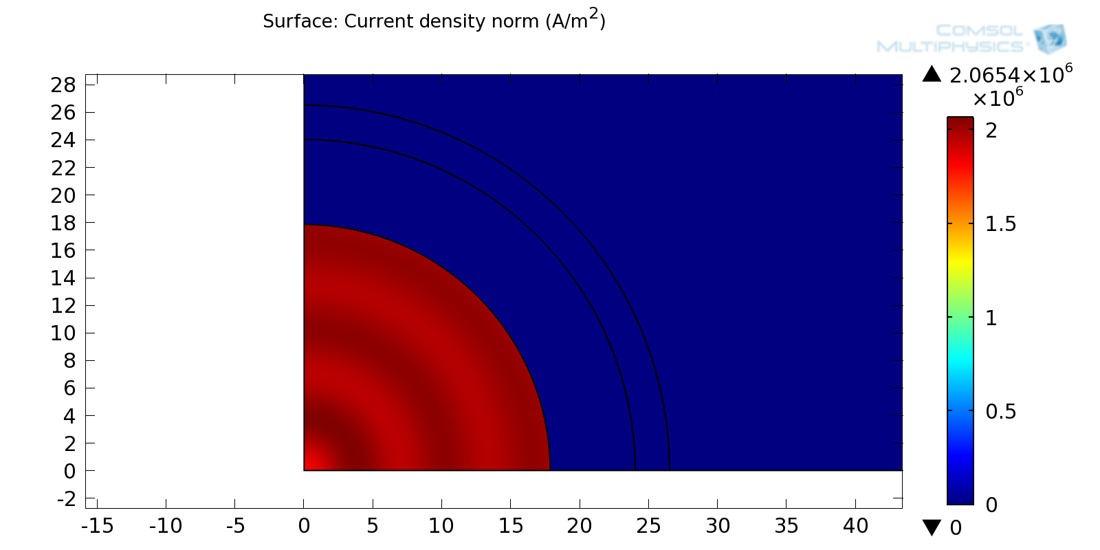

I'm trying to determine the steady state temperature of an XLPE insulated copper cable carrying a specified current using a 2D model. I've got the model working for DC, by first modelling the natural convective cooling of the cable, and then using the calculated heat transfer coefficient in a second model that uses the Heat Transfer (ht) and Magnetic and Electric Field (mef) interfaces. The final temperature for the DC case agrees with predictions.
To expand the model for AC, I have made the following changes:
1) Changed the equation form in mef from study controlled to frequency domain. I then specify the frequency after selecting user defined.
2) Under Model > Definitions, created an integration operator (intop1) on the domain that represents the copper area of the cable.
3) Under mef, replaced the external current density with a global constraint "intop1(mef.Jz)-500". I am only modelling a quarter of the cable, so the 500 represents a quarter of the total cable current of 2000A.

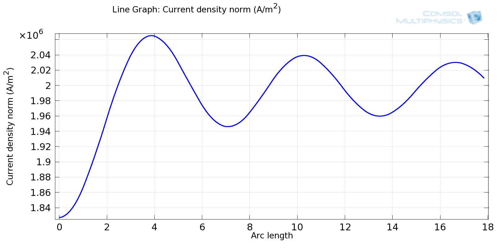

At very low frequencies, the AC model looks like the DC case, but a I increase the frequency the results become less and less like what I would expect. I've attached images showing the current density distribution in the copper at 5Hz. When I check the total current through the cable after the simulation, the global constraint does appear to be working with regards to the total current, but the distribution does not show the skin effect, but just some kind of simulation artefacts.
