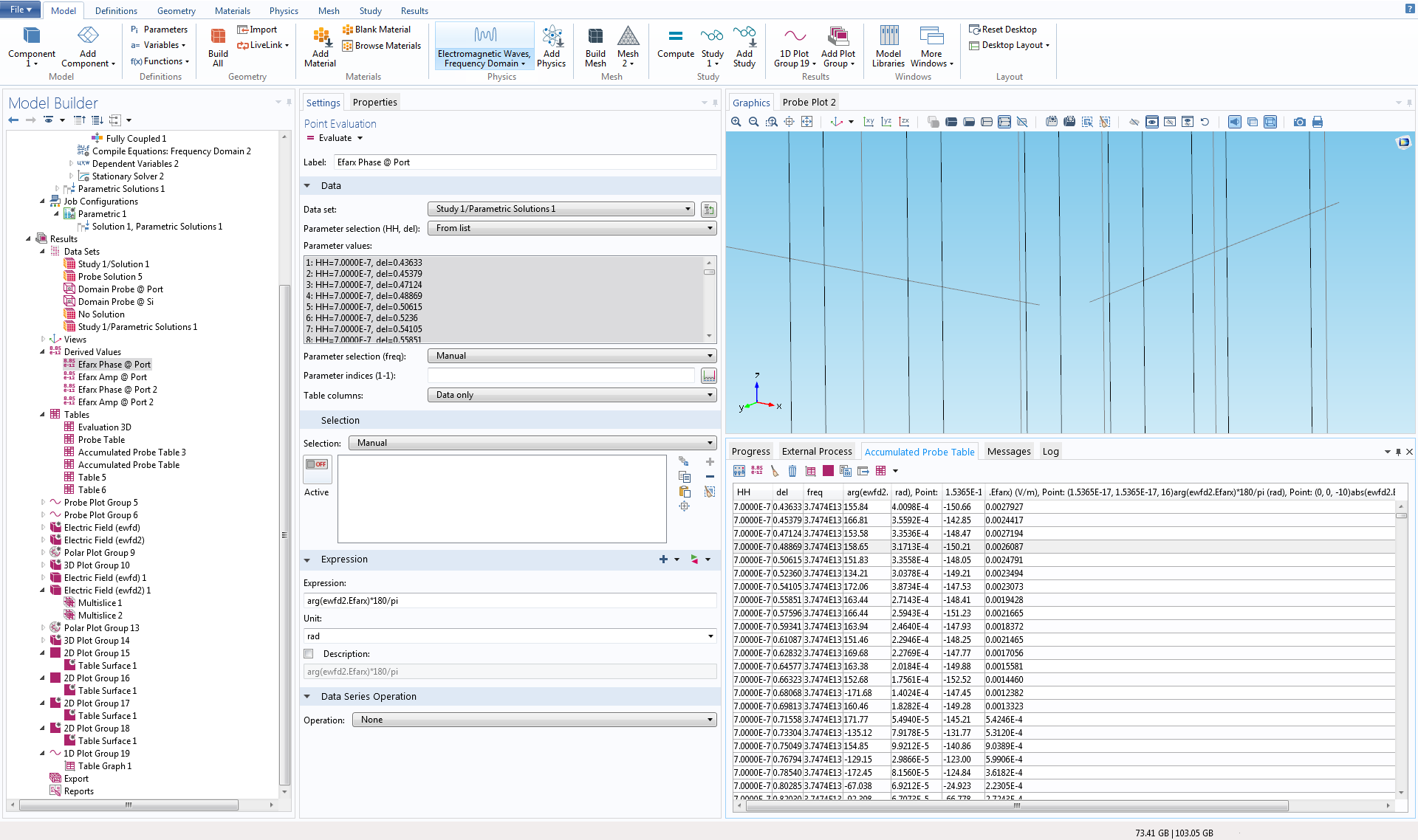

I've run a successful parameter sweep, but I cannot generate a Table Surface directly from the Accumulated Probe Table, as it says "Table does not contain filled data".
I think I might know the reason, but I do not know a resolution. COMSOL seems to be grouping the two parameters given in the Parameter Sweep (HH,del) as one parameter selection, while it considers my constant frequency parameter (freq), which is given under Stationary Solver 1-->Parametric 1, as the second parameter selection. Thus, the filled table has mismatched vectors for parameters 1 (HH,del) and 2 (freq). However, the acc probe table is showing these parameters properly as separate columns. Furthermore, I can run a Table Graph and delineate the parameters, so I know the (HH,del) parameter group can be separated in some manner. See the attached screenshot.
Any ideas on how to separate these parameters or how to establish a proper set of "filled data" for a Table Surface?
