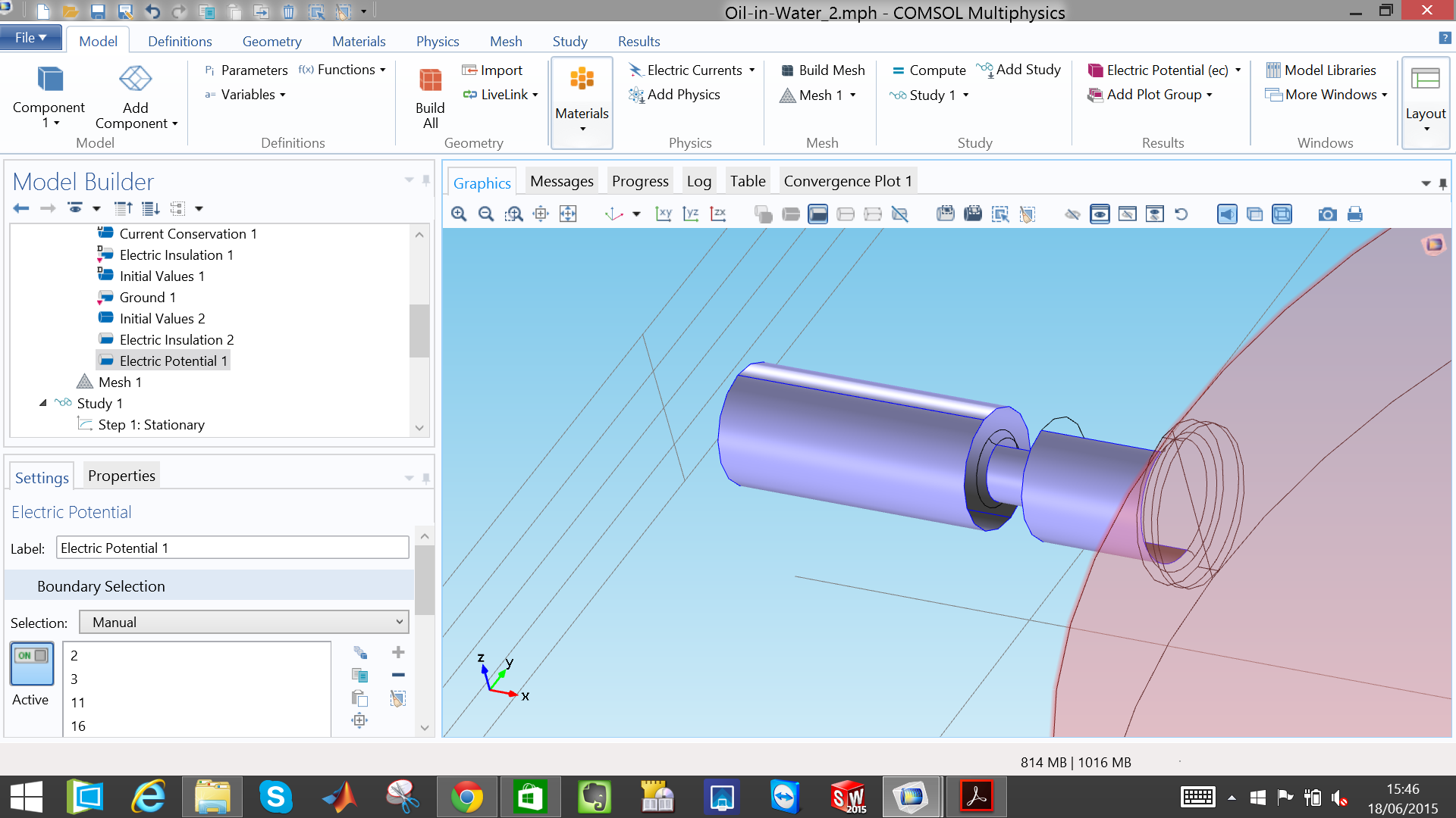

I'm new to COMSOL 5.0 and working on online image reconstruction ERT.
I'm trying to select an excitation electrode and in my model i need to select the interior part of the electrode but the cylindrical image prevents that.
How do i sort that out? Is there any setting that would support that?
Thanks

when you hoover with your mouse over the boundary and use the scroll wheel, you will cycle through the boundaries that lie below your mouse. When highlighted, just click left.
I can suggest the "introduction to COMSOL Multiphysics" guide for more tips on the user interface.

You have saved a life!!!
Thank you so much.
