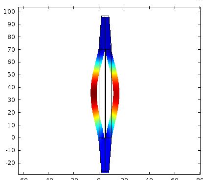

Hi friends,
I also having the problem of deformation above the physical limit. In my geometry there are 3 layers. The first one is an epoxy layer, Middle one is a glass fiberand the third layer is again the same epoxy material. While a mechanical load is applying on the outer layers , each domain moves beyond the physical limit. Please see the attached image. How Can I solve this issue.
Please send your valuable suggestions
Hi friends, I also having the problem of deformation above the physical limit. In my geometry there are 3 layers. The first one is an epoxy layer, Middle one is a glass fiberand the third layer is again the same epoxy material. While a mechanical load is applying on the outer layers , each domain moves beyond the physical limit. Please see the attached image. How Can I solve this issue. Please send your valuable suggestions
