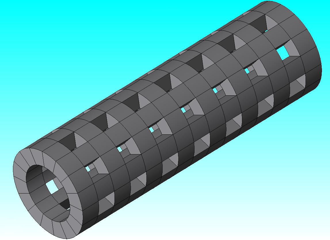

Finally I gave up trying to import and started constructing it using COMSOL. Now, I am stuck up at a point where I had to split my object at specific sections. Please find attached a figure of the geometry that I am trying to build.
Any insight on how I can create this geometry or any other possible ways to import from my CAD file?

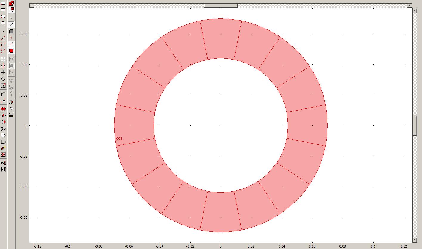

I had a 2D model made as shown in the attached figure 1, and extruded it to obtain the horizontal splits (as in figure 2). If there is some way to create sectional cuts on this , I would be very close to my desired geometry. Your expertise would be of great help with this.

Now for your gemoetry my approache would be to generate it as two circles and a diagonal vertical line that I would duplicate and rotate (CNTRL+C CNTRL+V then CR (no displacements) Rotate around 0,0 angle X°). This in 2D, then I would Coerce it to one solid (as I expect you have done from your image, extrude it N times and keep the items you want. All in COMSOL
Extrude N times did work! I didn't realize that extrude function could do a piecewise linear extrusion.
