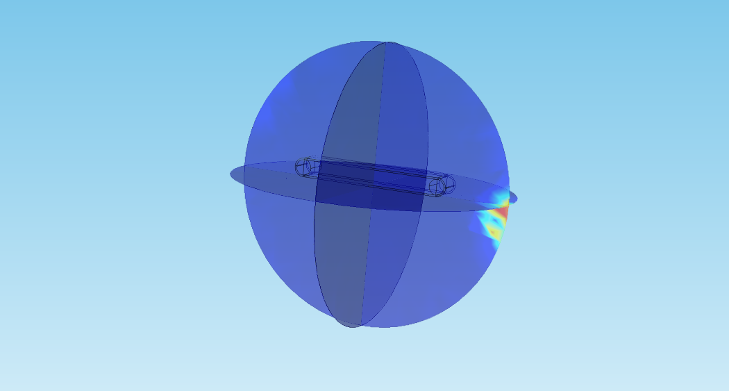

I have a simple geometry and I want to find the inductance and the resistance of the same. However, I do not understand why the computation takes so long for this. I wasnt able to compute fully due to processing ability of my PC. However, according to me, it should not take long.
www.dropbox.com/s/kktoh7c3rpxqam6/PCB_3Dmodel2.mph?dl=0
Can someone help me in explaining where I am going wrong ?

as far as I can see the moel does not contain a single turn coil or any other closed loop
structure but rather a plate.

Thank you for the reply. However, it is not exactly a plate, but the distance between the two plates is very small (in um) as compared to the length and breadth. If you zoom and see, i think you can see it.

I downloaded your model and just ran it. It took 2 mins and 3 secs. I have a three year old laptop with 8 GB RAM. If you have less than that, 3D models do not run smoothly.

I am running this on my university server, which I think has a 128 GB RAM. I am not sure as to why it takes so much time though,
Can you please send the file, with the mesh and the results . I will check it now.

I did not change anything, it is your file. The problem may be in the temporary disk size allocated to you. Check your comsol.ini file.

check out the no. of degree of freedom of your meshing model. if this is a large no. then you definately get more time for simulation.

hey its finely simulated in just 2-3 minutes or less.
check your comsol core settings if u changed......

I havent changed the settings. I am now looking into what could have gone wrong. It has taken me 40 mins now and the computation is still not over.
