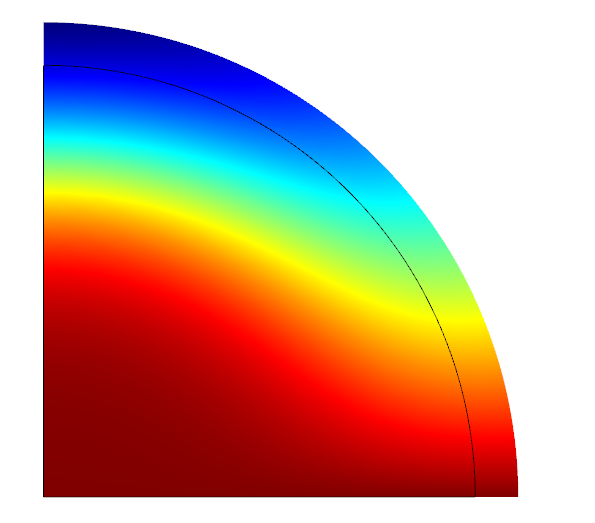

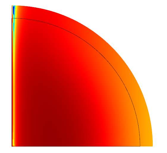

I found if I use 'd(solid.pm,r)' to calculate the derivative of pressure along the r direction, the result is very weird, like the Figure 1.
However, the 'd(solid.pm,z)' can give me the right distribution of derivative of pressure along the Z axis. as shown in the Figure 2.
Can anybody tell me the reason?

Posted: 1 decade ago 08.04.2015, 12:06 GMT-4
In axial symmetry, the analytical expression for the strain in the circumferential direction is
When the radius approaches zero (on the z-axis) this expression becomes problematic from the numerical point of view.
So when you take a derivative of the stress, the underlying operation will be to compute the r-derivative of the expression above. This is why you see disturbances close to the z-axis. The result will be very sensitive to the mesh size at small r-coordinates.
In the formulation. we do take measures to avoid zero-divide in the strain itself, but that does not protect against taking derivatives of it.
Henrik

Posted: 1 decade ago 09.04.2015, 04:37 GMT-4
I just realized the major issue here: The derivatives should be taken with respect to to 'R', not 'r'.
A quote from the user's guide:
"From a simulation perspective it is desirable to solve the equations of solid mechanics on a fixed domain, rather than on a domain that changes continuously with the deformation. In COMSOL Multiphysics this is achieved by defining a displacement field for every point in the solid, usually with components u, v, and w. At a given coordinate (X, Y, Z) in the reference configuration (on the left of Figure 2-4) the value of u describes the displacement of the point relative to its original position. Taking derivatives of the displacement with respect to X, Y, and Z enables the definition of a strain tensor, known as the Green-Lagrange strain (or material strain). This strain is defined in the reference or Lagrangian frame, with X, Y, and Z representing the coordinates in this frame. The displacement is considered as a function of the material coordinates (X, Y, Z), but it is not explicitly a function of the spatial coordinates (x, y, z). It is thus only possible to compute derivatives with respect to the material coordinates."
Henrik
Hi, I just realized the major issue here: The derivatives should be taken with respect to to 'R', not 'r'. A quote from the user's guide: "From a simulation perspective it is desirable to solve the equations of solid mechanics on a fixed domain, rather than on a domain that changes continuously with the deformation. In COMSOL Multiphysics this is achieved by defining a displacement field for every point in the solid, usually with components u, v, and w. At a given coordinate (X, Y, Z) in the reference configuration (on the left of Figure 2-4) the value of u describes the displacement of the point relative to its original position. Taking derivatives of the displacement with respect to X, Y, and Z enables the definition of a strain tensor, known as the Green-Lagrange strain (or material strain). This strain is defined in the reference or Lagrangian frame, with X, Y, and Z representing the coordinates in this frame. The displacement is considered as a function of the material coordinates (X, Y, Z), but it is not explicitly a function of the spatial coordinates (x, y, z). It is thus only possible to compute derivatives with respect to the material coordinates." Regards, Henrik
