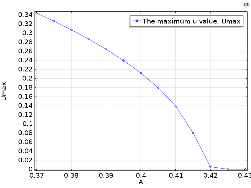

(i) making the Parametric Sweep with respect to the parameter A from 0.37 to 0.43 with a step 0.005,
(ii) evaluating the Surface Maximum, Umax, in the Derived Values and
(iii) plotting the maximum value of the obtained solution, Umax, against A.
Please find the plot Umax=Umax(A) attached as the file Umax.png.
From the table corresponding to this plot I can derive the value AcNum as the A value at which Umax becomes greater than 0.0001.

The difference, deltaAc, depends upon the choice of the mesh size. With the coarser mesh the AcNum decreases, which is expected Therefore, I tried
a) to decrease the mesh,
b) to use the complex meshes, such that the mesh is fine in the vicinity of the point (0,0) and is coarser far from it
c) to use the Adaptive Mesh Refinement
The outcome is counterintuitive: instead of coming closer to Ac from below, I find that AcNum goes to the value of about 0.422 that is higher than Ac. Any further mesh refinement does not help.
The best value deltaAc/Ac is about 5%.
