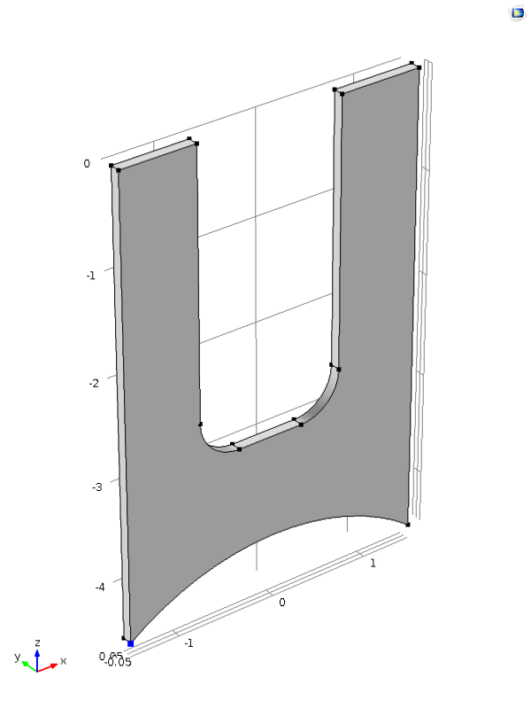

- add Fixed Constraint 1 (Figure 2)

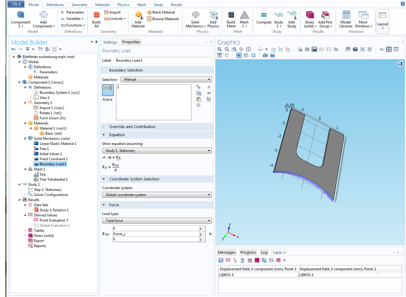

- add Boundary Load 1 as Total force in y (Force_y = 40[mN] Figure 3)

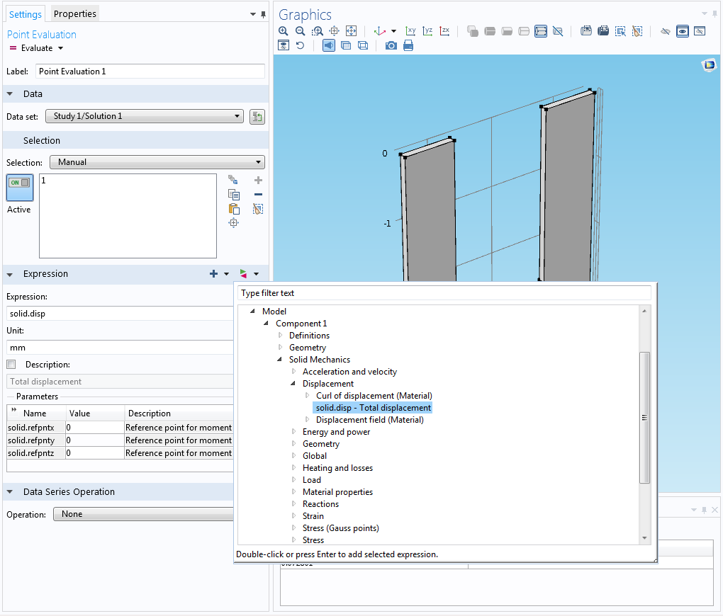

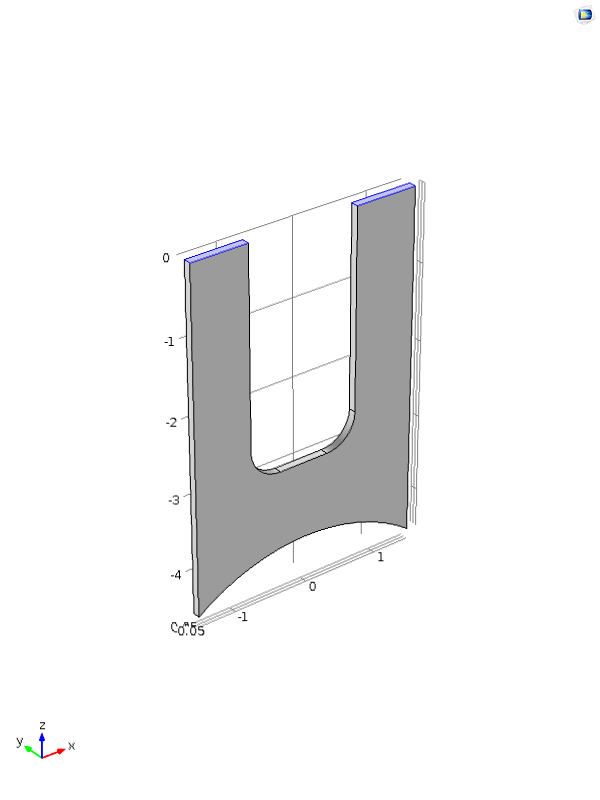

- add Point Evaluation Y (Select Point Figure 4)
- use expression Model -> Component 1 -> Solid Mechanics -> Displacement -> solid.disp
or Displacement field, X, Y and Z component

I didn't see any deformation of the ball, but a very large deformation of your thin blade, so I would suggest that you consider the non-linear geometry mode for such large deflexions, and compare your results.
Another point is do you have a static X body load or a "follower" ball-section-normal load, for these deformations that has some importance

The model is actually a neodymium magnet ball, fixture on a leaf spring and a magnetic forces (Y-axis) provides the deflected.

Posted: 10 years ago 01.04.2015, 15:19 GMT-4
Looks funny indeed, but your stress is also very high !
at least 100-1000x above yeld stress so I suspect a unit isue in your BC/Domain load there.
And you might have turned on "automatic" scaling ? that gives different scales for different directions
