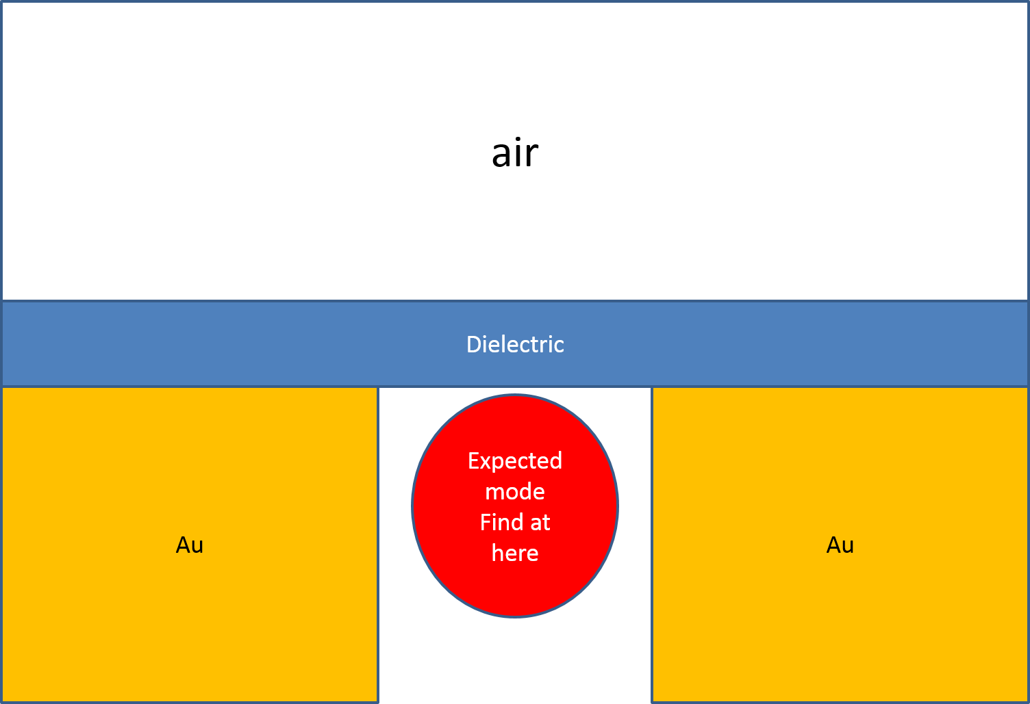

Recently I am trying to setup a model that can find the waveguide mode that we expected to exist in a special geometry (which has been illustrated in the ppt file).
basically, the upper space are infinite air, with an infinite slab of dielectric, and the bottom is a thick layer of Au, a narrow slot has been made to create a channel in the Au.
I am looking for a waveguide mode in the slot. right now I am using the PML boundaries. but it looks like the pml didn't work very well, it has some reflections. and I was told that within the same pml layer, the materials should be identical. I just don't know if the model that i set is reasonable or not.
I attached both the mph and ppt file together.

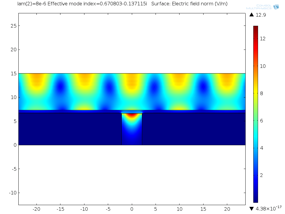

For the periodic BC, I suppose to use the "continuity" type right? But I looked after the previous post about periodic BC, it said that the continuity is somehow similar with PEC, why is that? and I know for my case I shouldn't use the floquet periodic because i can't define the kx vector.
I tried the periodic BC, and find the mode that I wanted, however, the mode kinda of spread out in the entire simulation area. I have attached the png file, you can see that there are some field distribution outside my waveguide. I am wondering how these parts will affect the effective index? Will they increase the imaginary part of the effective index?
Thanks,
Runyu

and also, does COMSOL has the function that allows me to do some post-calculation/manipulations?
like truncate a specific area and re-calculate the neff?
Thanks,
Runyu
