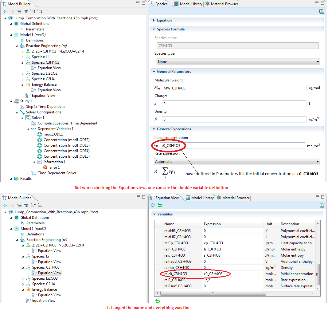

I'm not sure if this thread is still alive or relevant anymore, but I have just encountered the same problem while modeling Reaction Engineering. The circular variable error came because I have used the notation of a parameter the same like the model uses (as Ivar already said).
Just to be clear, I took a screenshot.
