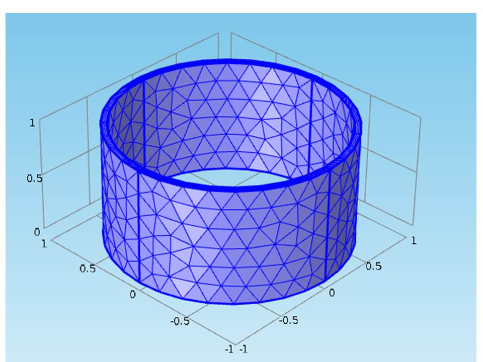

No problem, if you first mesh the inner surface. Look at the attached image.
Lasse
No problem, if you first mesh the inner surface. Look at the attached image. Lasse

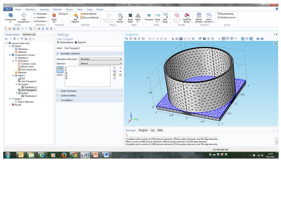

Posted: 1 decade ago 10.02.2015, 16:32 GMT-5
I was wrong, it was rather straightforward. First I meshed the tube, then the remaining parts of the plate surface. Finally swept mesh across the plate.
br
lasse
I was wrong, it was rather straightforward. First I meshed the tube, then the remaining parts of the plate surface. Finally swept mesh across the plate. br lasse
