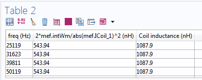

Naturally, I decided to double-check the inductance value using
L = 2*intWm/(mef.ICoil_1^2)
but this gives exactly 1/2 the value mef.LCoil_1 provides. So can someone help me with the missing factor of 2?

Okay, I figured it out. Because these are AC fields, not DC, the energy is time averaged. The average field is the RMS amplitude (1/sqrt(2)). The energy goes as the average field squared, and thus a factor of 1/2 from the DC formulation.
