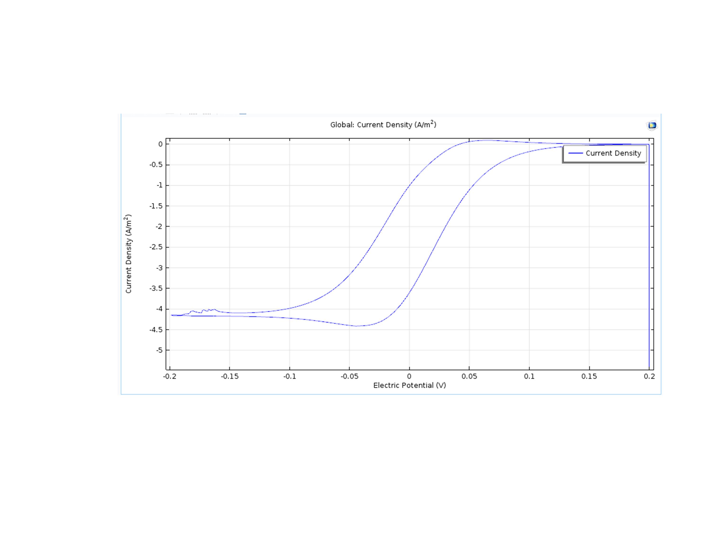

Posted: 10 years ago 25.06.2015, 14:17 GMT-4
I got some result but limiting current is not what I expect to get.
I choose automatic meshing here in this results.
I got some result but limiting current is not what I expect to get. I choose automatic meshing here in this results.
Posted: 10 years ago 02.07.2015, 10:40 GMT-4
Hi Lesse
I think I found it's problem. it is all about meshing. If I choose good meshing the answer will be close to what I am looking for. But I run to a problem. when I increase the flow rate to ml, there will be an error in simulation (laminar).
"Failed to find a solution.
Maximum number of Newton iterations reached.
There was an error message from the linear solver.
Very ill-conditioned preconditioner.
The relative residual is more than 1000 times larger than the relative tolerance.
Returned solution is not converged"
Would be please advise me in this case?
Thank you very much.
Fereshteh
Hi Lesse I think I found it's problem. it is all about meshing. If I choose good meshing the answer will be close to what I am looking for. But I run to a problem. when I increase the flow rate to ml, there will be an error in simulation (laminar). "Failed to find a solution. Maximum number of Newton iterations reached. There was an error message from the linear solver. Very ill-conditioned preconditioner. The relative residual is more than 1000 times larger than the relative tolerance. Returned solution is not converged" Would be please advise me in this case? Thank you very much. Fereshteh

Posted: 10 years ago 02.07.2015, 14:51 GMT-4
Try this (attached). I updated to version 5.1.
The idea of meshing is that close to the electrode very dense mesh is needed to reach better accuracy in current calculation. Swept mesh with distribution highlights the fact that the flow profile is parabolic and close to the boundaries changes are the largest. In y direction the mesh does not need to be very dense, except close to the electrode.
br
Lasse
Try this (attached). I updated to version 5.1. The idea of meshing is that close to the electrode very dense mesh is needed to reach better accuracy in current calculation. Swept mesh with distribution highlights the fact that the flow profile is parabolic and close to the boundaries changes are the largest. In y direction the mesh does not need to be very dense, except close to the electrode. br Lasse
