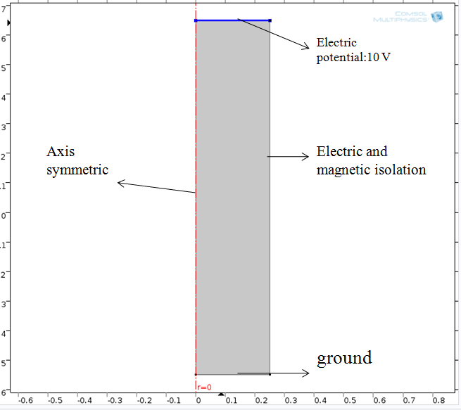

As we all know, if there is a current in conductor, there will be a static magnetic field around it.If i simulate it using a 3D numerical model, i can get the static magnetic field. However, when i simulate it by a 2D axisymmetric model to reduce the computation , the magnetic field equal 0 ! Both model use the "elecric and magnetic field"and the boundary condition is same. WISH SOMEONE CAN HELP ME .THANKS A LOT.

thanks very much about your attention.However,i have built a similar numerical model in 3D and got the magnetic field, so there is no need for the "air" and a comlete current circuit .Also ,i have bulit this 2D axisymmetric model using COMSOL 3.5, and there is a B_phi which is what i need.

Thanks so much about your reply. I have up the model about 3D and 2D axisymmtric. I bulit a very simple physical model . Just give one side a electric ptential, the other side is ground. The magnetic field is what should be care about. But the results is different, and in 2D axisymmtric model we cannot get the B in phi direction.

I had a look into your models and although the setup is a bit unusual, I think the 3D solution is correct. The potential and ground BCs should work because they are at the model border.
As far as I see, the 2D axial model should be equivalent. I would suggest to forward this to the COMSOL support.

You are using the option "Out-of-plane vector potential".
Since the B-field in your model is in the azimuthal direction, you must use 'In-plane vector potential' or 'Three-component vector potential'. In addition, you probably need to add 'Gauge Fixing for A-Field'.

Hi Henrik,
when I checked Wenzhi's 2D model I also changed the vector component setting to 3 component but didn't think about the Gauge fixing, although the solver message is quite typical for it.
This brings me to the question what criteria decide whether the Gauge Fixing is required or not. I had quite a couple of discussions about that, also with COMSOL people during trainings, but there was no clear answer for it. It remains a trial and error thing. And even when the solver converges one can't be sure about the validity of the result. Then looking at the E-field or A-field sometimes shows a noisy picture that indicates the Gauge Fixing might be required.
Of course one would like to avoid it, particularly in the 3D case, because it doubles the memory demand.
Are there clear criteria? Or do we need to try and fail and finally succeed?
