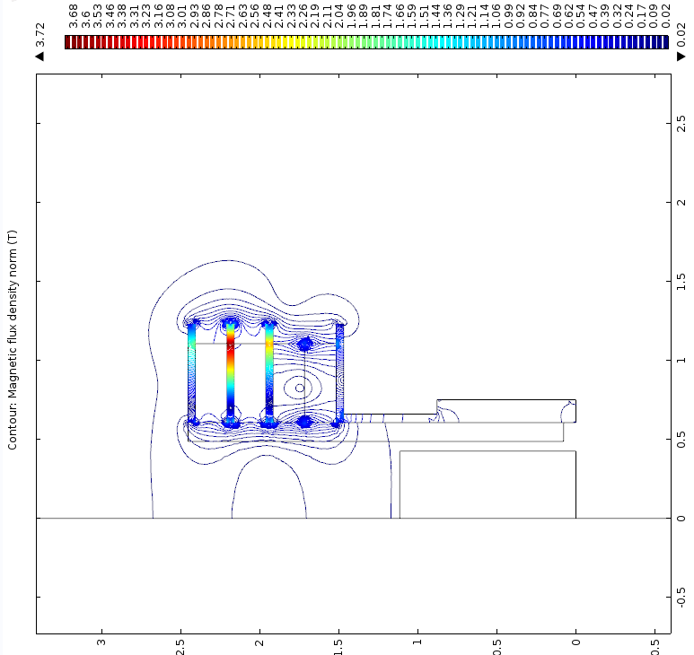

I checked it seems that magnetic flux is not an explicit output in COMSOL. I think you should integral B(x,y,z) over the your model surfaces. You can use "More derived values" option in the "Results" menu to take a surface integration.

Thanks MAEQEng,
That definitely seems like a step in the right direction. Now my problem is integrating the flux density vector. Your suggestion seems to work fine to integrate any single component of the vector, but how do I tell COMSOL that I want an expression for the flux at every point? Currently it is giving me a scalar value which I'm assuming is the flux through the entire area of my model. Obviously, this doesn't lend itself well to a contour plot.
Any additional thoughts you could provide on this would be greatly appreciated!

Chris,
you are somehow mixing things here. You correctly state that flux is the integral of the flux density vector over a surface. So flux is not a function of a point. The integration of the flux density vector gives a flux vector, not a scalar.
It is unclear what you mean with 'magnetic flux function'. The COMSOL plot shows flux density contours. There isn't something like flux contours, remember flux is an integral. Maybe you want streamlines, which can be a visualisation of flux. They are available in COMSOL, but you have to be careful about the choice of the start points otherways streamlines can be misleading. Make sure you understand what streamlines actually are!

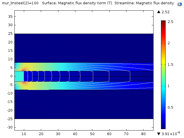

Posted:
1 decade ago
12.01.2015, 10:02 GMT-5
Hi Chris,
it is perfectly possible to generate a flux plot in Comsol. I have attached a model which shows the result you are after. You can use the same settings in your model to generate a similar plot.
Mark
