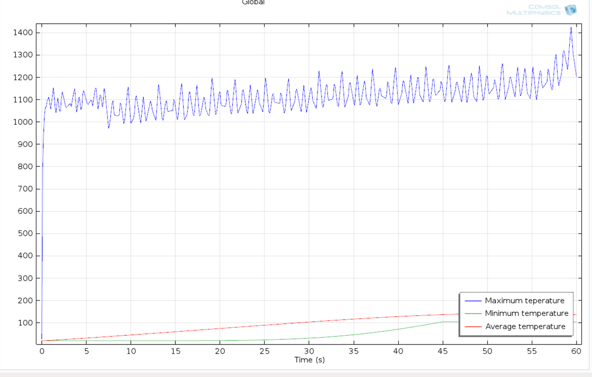

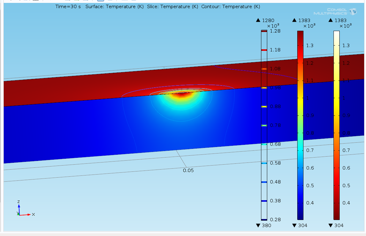

I did another test:
-I removed the rectangle and used the gaussian pulse (suppose a gaussian beam instead of the wanted tophat), as in the example. Change the expression for the analytic component into:
p_laser*gp(x-v_feed*t)*gp(y) , with gp1: the gaussian pulse.
So far it's looking promising. The results (about 1100°C) are realistic.
However, when looking at the attached image comsol2, I believe it is strange there is this variation in the max. temperature. Why is this?
So, the moving problem is fixed. But what about how to create a Top Hat distribution. Anyone an idea?
Attached the current model.
I did another test: -I removed the rectangle and used the gaussian pulse (suppose a gaussian beam instead of the wanted tophat), as in the example. Change the expression for the analytic component into: p_laser*gp(x-v_feed*t)*gp(y) , with gp1: the gaussian pulse. So far it's looking promising. The results (about 1100°C) are realistic. However, when looking at the attached image comsol2, I believe it is strange there is this variation in the max. temperature. Why is this? So, the moving problem is fixed. But what about how to create a Top Hat distribution. Anyone an idea? Attached the current model.

About the top hat: you can use something like p_laser*step1(sqrt((x-v_feed*t)^2+y^2)), where step1 is 1 when its argument is smaller than r and 0 otherwise, with r the radius of your top hat.
About the variation of the maximum: I have not counted but it seems like the amount of peaks in the t-Tmax graph is roughly equal to the amount of mesh elements encountered along the length of the bar. Try a finer mesh and see if it makes any difference.
