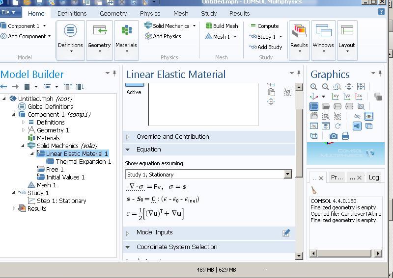

I want to add Thermal Expansion in solid structure under Linear Elastic Material.
When I see equation, theses equations are wrong for thermal stress.

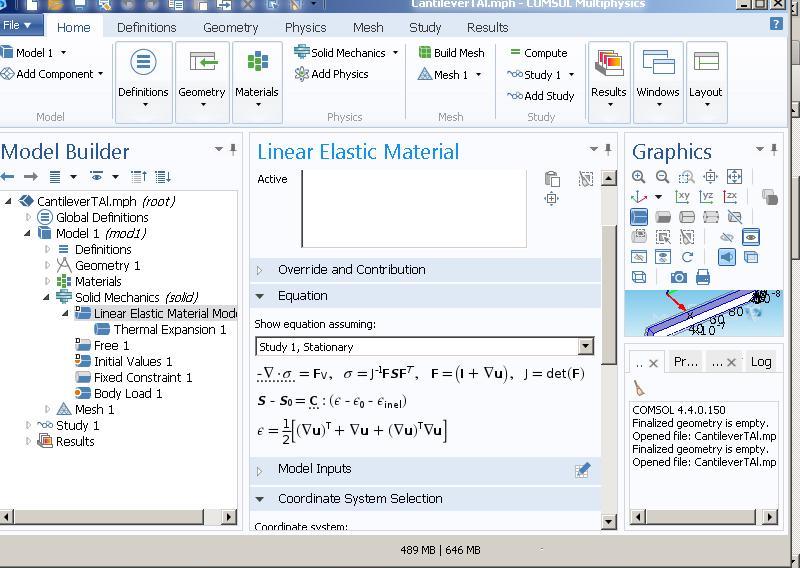

I download a example from this Forum for Thermal Expansion and see these equations are correct.
Would you please why my equation are wrong?

Both are correct. One is based on the Green-Lagrange strain (for geometric nonlinearity), and the other is based on infinitesimal strains (does not account for geometric nonlinearity).
