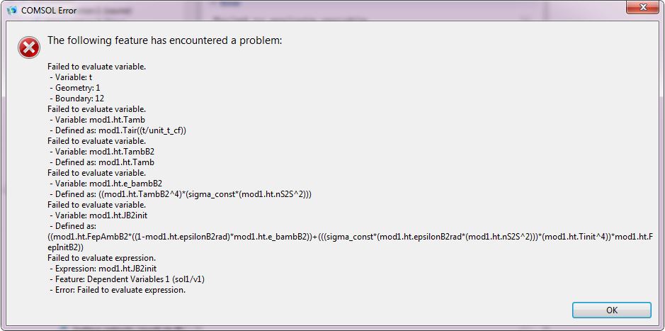

I am trying to simulate and validate an air solar collector model. I would introduce time-dependant (hourly time step) input for air temperature and solar radiation using an interpolation function but running the simulation some errors occur (see attached file).
I set the unit in the interpolation function branch: argument=s; function=K (e.g.) and use the name function wherever I need recall it as: name(t).

if you are getting this error while running stationary solver, it probably doesn't understand the time variable t, so it helps, if you define t as a parameter and set it to zero; time-dependent solver will ignore that fact.
I am not completely sure, but you coud try that.
Ivars
