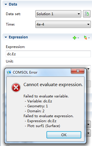

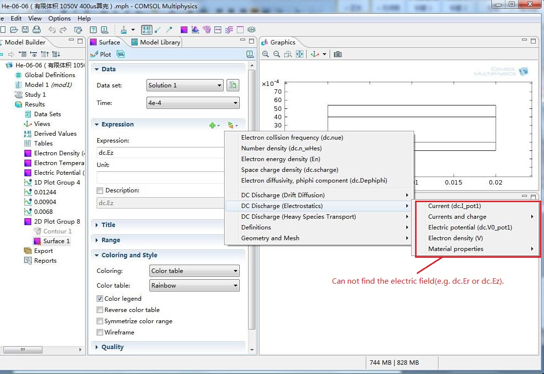

Posted: 1 decade ago 21.01.2015, 21:16 GMT-5
Dear Mr. Gritter,
My model is a 2D DBD with planar electrodes. I try to plot the Electric field again, But under the expression selections, I still can't find it. So I type dc.Ez in the expression, it come out a error: Can not evaluate expression.(see the Attach File)
Hoping for your replying.
Zhiming Huang
Dear Mr. Gritter, My model is a 2D DBD with planar electrodes. I try to plot the Electric field again, But under the expression selections, I still can't find it. So I type dc.Ez in the expression, it come out a error: Can not evaluate expression.(see the Attach File) Hoping for your replying. Zhiming Huang
Luke Gritter Certified Consultant
Posted: 1 decade ago 22.01.2015, 09:22 GMT-5
If you have a 2D model, there is no electric field in the z-direction. The electric field components are dc.Ex and dc.Ey.

Posted: 1 decade ago 22.01.2015, 09:25 GMT-5
Oh, it is 2D axisymmetric model.
Posted: 1 decade ago 22.01.2015, 09:35 GMT-5
Which version of COMSOL are you using? Is domain 2 a plasma or dielectric domain?
Luke Gritter
AltaSim Technologies
Which version of COMSOL are you using? Is domain 2 a plasma or dielectric domain? -- Luke Gritter AltaSim Technologies
Posted: 1 decade ago 22.01.2015, 09:39 GMT-5
I use the 4.3a, and the domain 2(the middle one) is plasma.
Posted: 1 decade ago 22.01.2015, 10:07 GMT-5
The implementation is somewhat different in the older versions, and I'm not sure whether there is a way to postprocess the electric field in version 4.3a. In versions 4.4 and 5.0, at least, the electric field can be visualized using the variables mentioned above.
