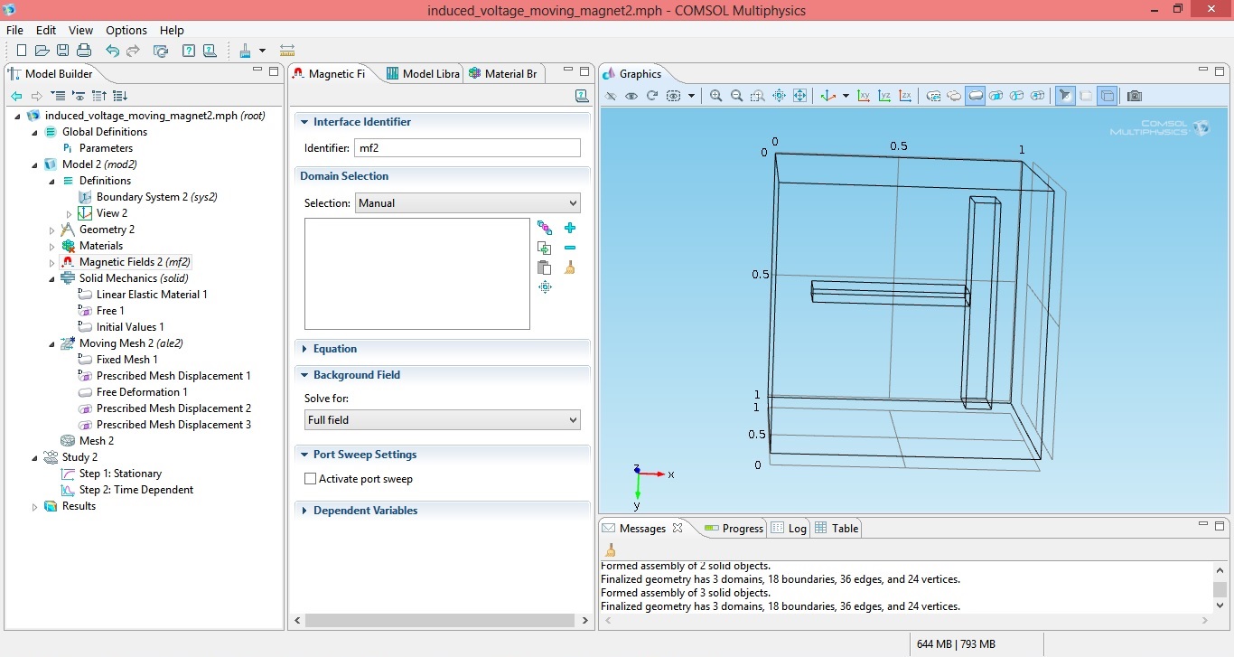

Seems that my understanding of the problem you are trying to solve was incorrect. Based on your latest description, you need to set up the problem the other way around: prescribe sinusoidal motion to the magnet and calculate induced voltage in the coil. This is somewhat simpler problem since you don’t need Solid Mechanics interface and no Maxwell’ stress tensor is required: just prescribe magnet motion in the Moving Mesh interface. Then, induced voltage can be calculated by integrating electric field over cross-section of the coil along the coil circumferential loop.
Sergei

Although I am not sure what you are trying to achieve, the attached is modified file with beam forced vibration.
Sergei

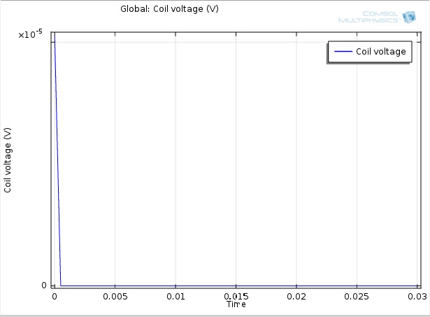

And off course thanks for the beam forced vibration and the time dependent study, it is exactly in accordance to what I was striving for. And in the output of induced voltage there is a straight line (file attached) at zero but in previous case of Maxwell stress it was a sinusoid. I am confused in that, please guide about that.

Sir please guide me about that last issue, its a very humble request and I will not disturb you after that. It really is very very important for me.
Just guide me about the Sinusoid output of VOLTAGE which a straight line in the last file send by you. Is voltage induced or I am getting it wrong? Whereas Vibrations are perfect and their sinusoid is there.

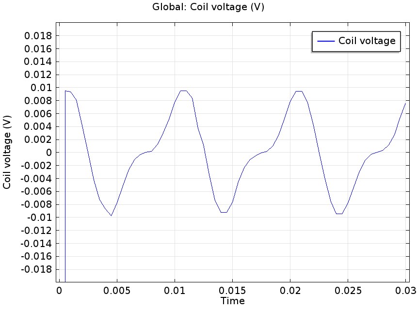

Attached is model with induced sinusoidal voltage of the coil.
Sergei
