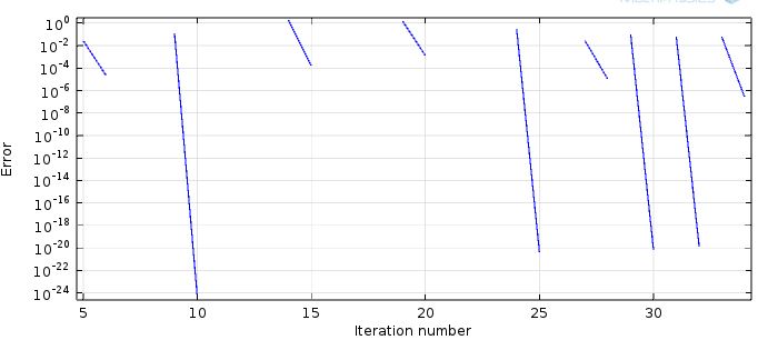

I read following article in COMSOL about Improving Convergence of Multiphysics Problems:
www.comsol.com/blogs/improving-convergence-multiphysics-problems/
It says that the error plot should go down monotonically and smoothly. However, I got an error plot in which the curve is not continuous. I attached it to this comment. Is there any problem with this error plot or not? My outputs seems correct but I am not sure about this.
Thanks,
Mohsen

I have the same problem!

Hi there
You can built a better mesh and try it. Here is an idea to test how good is your mesh.
www.comsol.fr/blogs/size-parameters-free-tetrahedral-meshing-comsol-multiphysics/
Best
