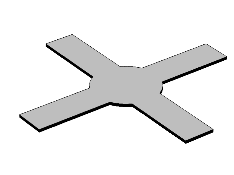

I am using mems module, solid mechanics interface, linear elastics material model, including geometric nonlinearity (large dimensions: on).
Even when I change the Young's modulus in the material parameters my results are still different from the experimental data (deflection should be much bigger).
I would be very thankful for any hints how to build this model. The comsol file of my model is also attached.
