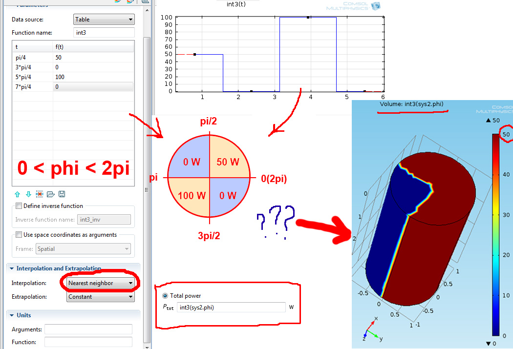

There is 3D model. Heat transfer module. I need to set Heat Source depended on "phi"-coordinate.
I defined a cylindrical coordinate system (sys2) with default settings, also defined an interpolation function for heat source (int3) - table f=f(t), where t [rad], f [W]. Then in Heat Transfer in Solids --> Coordinate System Selection --> Cylindrical System 2 (sys2), then I created Heat Source with Total power = int3(sys2.phi).
In result i have incorrect calculation of Heat Source (see attached picture).
What have I done wrong?
