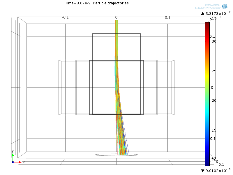

Hi, you can either make a Poincare plot or use the Phase Portrait to generate the plot you want. See the attached (V4.3b) model for an example on how to do this.

Another question concerning the 2D-plot: is there a possibility to add a "grid" to the plot, for a better visualization of the particle position?
I would like to ask for another advice concerning the same setup:
(it does not concern the 2D plot anymore so maybe I should open a new thread(?))
Since I want to resolve the particles depending on their charge, I would like to add an electric field, resulting from two electrodes with opposite electric potential. In particle physics we call this a "Thomson parabola".
Is there a way to compute the particle trajectories depending on a magnetostatic AND an electrostatic study?
Because I can only select one study in the"Values of dependent Variables" in the settings window of the particle tracing study.
It is not possible to use the "mef"-module because it describes electric/magnet fields that evolve from the SAME object.
Also, checking both "mf" and "es" in the Magnetostatics study settings window does not work (the electric field has no impact on the particle trajectories).
Thank you in advance for another (hopefully the final) advice.
Not directly. You could use the "Streamline" plot to get the same effect though. See the attached (V4.3b) model.
Yes, there are two ways of doing this.
1. Solve for the magnetostatics and electrostatics in the same Study, then pass this solution to the particle tracing study.
2. Solve for the magnetostatics first and pass this solution to the electrostatics study, then pass the electrostatics study to the particle tracing study (see the "Quadrupole Mass Spectrometer" model in the AC/DC Module Model Library for an example of how to do this)

I would like to add a comment to the model proposed by Daniel, in the 2D Plot Group 2 the Phase Portrait 1 must be employed with qy on the x-axis and cpt.vy on the y-axis to get the proper phase portrait (the beam emittence) and not the trace of the beam as in Poincaré scheme

Dear Daniel,
Studying the example you attached I couldn`t recognize the main difference between the Poincare Plot and the Phase Portrait. What is difference between them in the context of the example?
I`ve spotted that the streamlines are limited by the domain (by the diameter of the cylinder). Is it possible to trim out the streamlines to a desired length?
