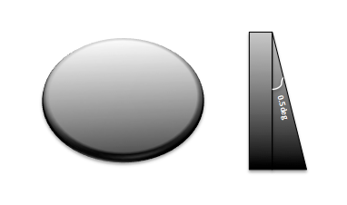

How can we design a glass wedge layer tend a 0,5 degree angle from a thin layer in the mirror cylindrical at 3D space ?

I would propose: draw a 3D cylinder, add a box, rotate it by 0.5° and place it accordingly to overlap part of the cylinder then take the difference cylinder - box you will then have your wedge
Hi I would propose: draw a 3D cylinder, add a box, rotate it by 0.5° and place it accordingly to overlap part of the cylinder then take the difference cylinder - box you will then have your wedge -- Good luck Ivar
