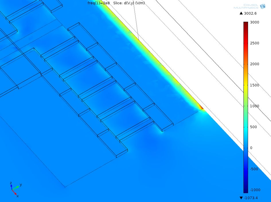

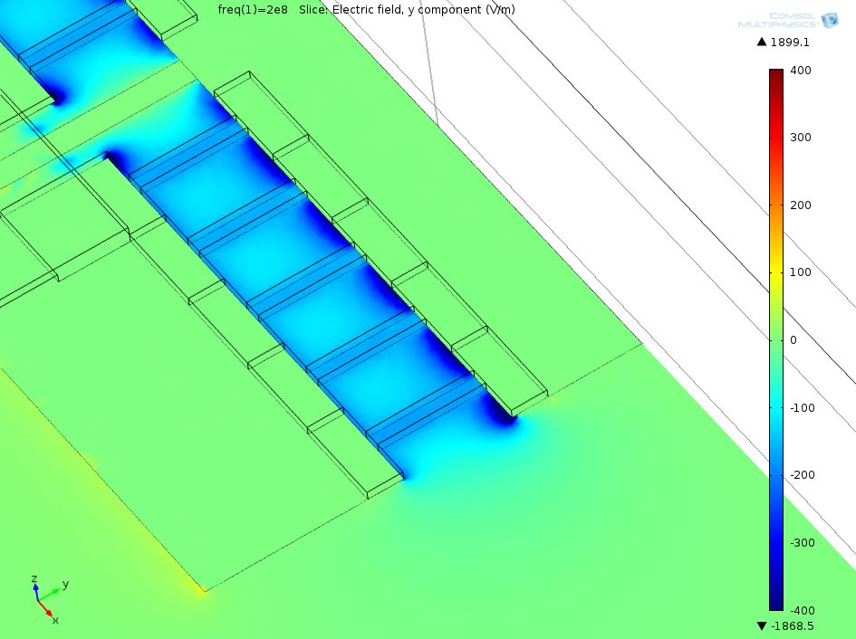

I have attached screenshots of d(V,y), and Y component of E field, respectively, plotted in the same plane. From my understanding, these should be equal, which is clearly not the case in my simulation.
Is the V field somehow calculated based on the bulk impedance seen at the terminals, ignoring the geometry? This is the only explanation I can come up with...

first a few tricks:
when you add a view with "hide" make several view, one standard, one perhaps with Geometry Objects hidden (for easier geometry creation this can often also be made by sorting the geometry object nodes up and down) and one with FEM entities hidden. Often I make a special selection list Hidden1 that I refer to in the "hide entities" list and then its easier to make parts appear and disappear. You might want to add several Hide entities, to distinguish domains from boundaries ...
Now when you measure fields, do not use the details of a sharp edge, what is the derivative of of the field along an edge ? tangentially it's possible to derive something, but perpendicular to the edge ?
Normally you should not really trust results , of derivative type, from anything else than domains and at best boundaries, provided your mesh is resolving correctly the gradients normal to the boundary.
My rule monitor only the 2 highest level of FEM entities (domains and boundaries) consider with great care any thing lower (edges points)
Edges heritage their values from the adjacent boundaries, as boundaries gets their values from local boundary physics and from the up/down domains etc (points from the intersecting edges, but what about the other directions ?)

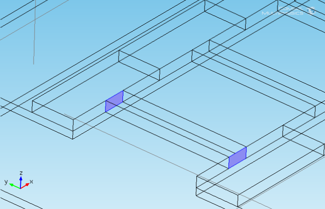

I have now run simulations at 1kHz and 10Mhz with boundary probes measuring average voltage on each end of a resistor. At 1kHz the difference is 0.83V, and at 10Mhz, it is -0.024V... Meanwhile, integrating the electric field over the length of the resistor gives 0.1V at both 1kHz and 10Mhz. So this confirms the slice plots in the PDF I attached earlier.
I have marked the boundaries that i probed for the voltage measurement in the attached image.
Strange! And even if I made some mistake in the model, I don't see how that could make E field and V field not correspond... And to make things even weirder, the correct V field is actually appearing between terminal and ground, it just isn't dropping over the resistors!

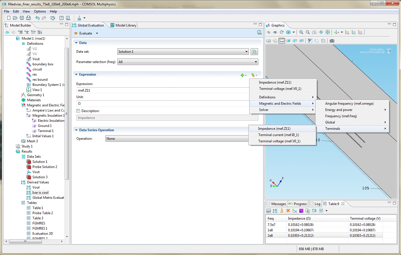

As far as I know, mef only gives acces to the terminal complex impedance - see attached screenshot.
At 200MHz, i get Ω = 0.10303+0.21212i, suggesting that the circuit is predominantly inductive.
Rough inductance calculation based on simple vertically spaced tracks formula:
At 200Mhz, this gives:
Which corresponds well with the lumped port impedance from comsol.

As far as I know, mef only gives acces to the terminal complex impedance - see attached screenshot. At 200MHz, i get Ω = 0.10303+0.21212i, suggesting that the circuit is predominantly inductive. Rough inductance calculation based on simple vertically spaced tracks formula: [math]L=\frac{\mu l h}{w} \leftrightarrow L=\frac{\mu_0 (2mm \cdot 0.36mm)}{5.45mm} = 166 pH[/math] At 200Mhz, this gives: [math] \Omega = 2 \pi f L i = 0.208i \Omega [/math] Which corresponds well with the lumped port impedance from comsol. (Edit: When I earlier mentioned that the imaginary component of the fields was negligible, I was referring to the results at 1MHz and 10Mhz, which still show the spurious V field as shown in the pdf.)

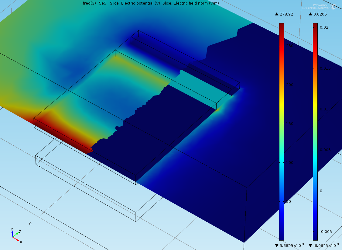

And here we go!
I made a simplified geometry, and the discrepancy between V and E persists!
Check it out, the attached screenshot shows a comparison of the V field and E field at 500kHz, made by applying complementary filters to the slice plots of V and E.
Also attached is the cleared model, it took 5 mins to sweep four frequencies on my workstation, but that is because I made the mesh quite fine in order to accurately resolve the skin depth (I wanted to rule this out as a possible cause). You can just change to a fine physics derived mesh and it will run much quicker, with not much different results.
Looking forward to hearing what you think :)
And here we go! I made a simplified geometry, and the discrepancy between V and E persists! Check it out, the attached screenshot shows a comparison of the V field and E field at 500kHz, made by applying complementary filters to the slice plots of V and E. Also attached is the cleared model, it took 5 mins to sweep four frequencies on my workstation, but that is because I made the mesh quite fine in order to accurately resolve the skin depth (I wanted to rule this out as a possible cause). You can just change to a fine physics derived mesh and it will run much quicker, with not much different results. Looking forward to hearing what you think :)
Posted: 1 decade ago 06.05.2013, 05:38 GMT-4
Hello!
You should add "gauge fixing for A-field" to your Ampere's Law; only this will give you a correct potential calculation.
The E-field is already ok.
Ralf
Hello! You should add "gauge fixing for A-field" to your Ampere's Law; only this will give you a correct potential calculation. The E-field is already ok. Ralf
