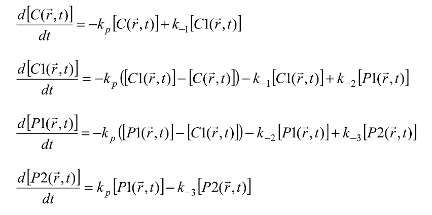

Posted: 1 decade ago 07.06.2013, 21:26 GMT-4
Hi Jens,
His response was also important to me. However, I need to make functions that vary in position and in time (attached)! shall ye make help me please? Therefore tried to declare functions and also no success.
Thank you.
Jânio Anselmo.
Hi Jens, His response was also important to me. However, I need to make functions that vary in position and in time (attached)! shall ye make help me please? Therefore tried to declare functions and also no success. Thank you. Jânio Anselmo.
Magnus Ringh COMSOL Employee
Posted: 1 decade ago 10.06.2013, 03:25 GMT-4
It seems that you should be able to use a Domain ODEs and DAEs user interface for specifying a "distributed ODE", where the right-hand side can depend on the spatial coordinates in the domain.
Magnus Ringh, COMSOL
Hi, It seems that you should be able to use a Domain ODEs and DAEs user interface for specifying a "distributed ODE", where the right-hand side can depend on the spatial coordinates in the domain. Best regards, Magnus Ringh, COMSOL
Jânio Anselmo Engenharia Biomédica
Posted: 1 decade ago 15.06.2013, 18:50 GMT-4
Hi Mr. Magnus.
Firstly thanks for your reply! I'll be performing your second statement! Warning on new questions!
Thank you.
Jânio Anselmo
Hi Mr. Magnus. Firstly thanks for your reply! I'll be performing your second statement! Warning on new questions! Thank you. Best regards, Jânio Anselmo
