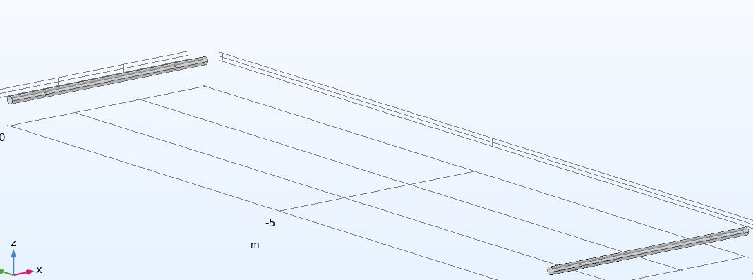

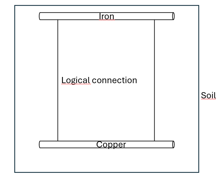

The module used is AC/DC Electric Currents. I have a model in which I want to study how the current is distributed in two buried pipes. The external environment, which represents the ground, is modeled as the outer semicylinder. The two pipes are made of copper and reinforcing steel embedded in concrete (with a parallelepiped shape). A normal current density source has been applied to the flat base of the semicylinder, the other one represents the ground. I would like to connect the two pipes to see the interference between them in terms of current distribution. This connection should only be logical, without any physical element connecting them, as if an isolated conductor connects them without interacting with the surrounding ground. How can I achieve this? In other words, I would like to analyze how the current distribution in one pipe directly interferes with the other through these connections. How can I do this? The boundary conditions already applied are a normal current density of 0.001 A/m² and electrical insulation on the lateral faces of the semicylinder and the last one simulates the ground.

My purpose is to create logical connections between these two materials, and I want these connections to be logical, without adding another physical element in the ground, I mean these connection as if they were isolated conductors that do not interfere with the surrounding environment. In the image, I have identified the boundaries that are relevant for the connections between the two materials. I don't want to impose scalar boundaries because I'd like the software to adapt the solution. Therefore, I have created two identity pairs, applying a floating potential condition to each of them. I don't know if it's the best solution, this is the reason why I am kindly requesting forum assistance.
