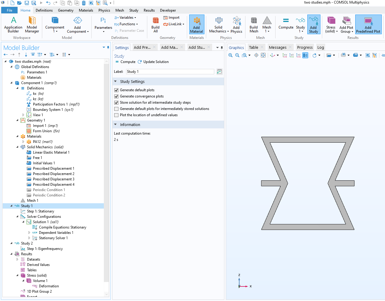

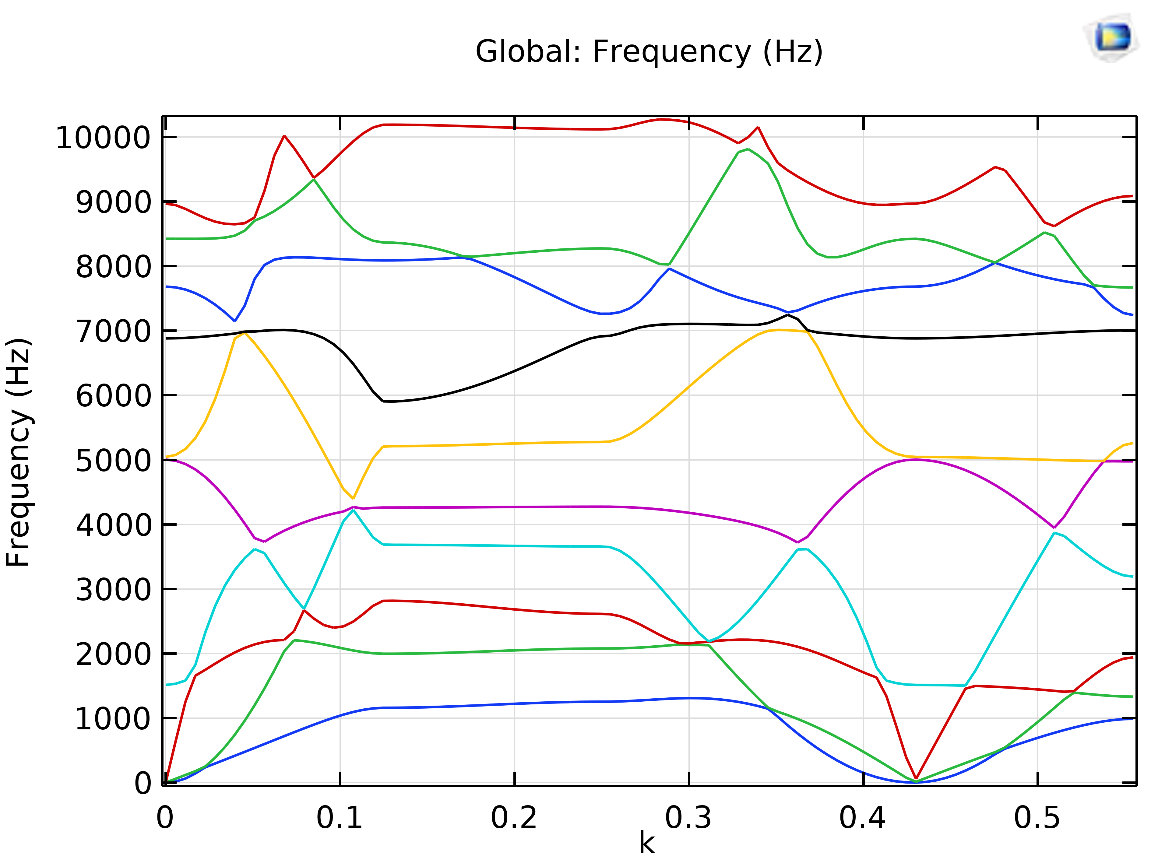

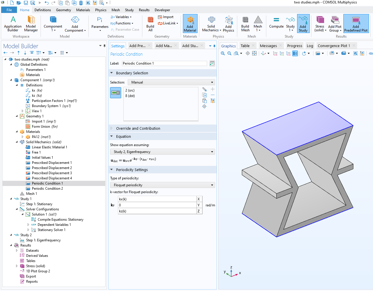

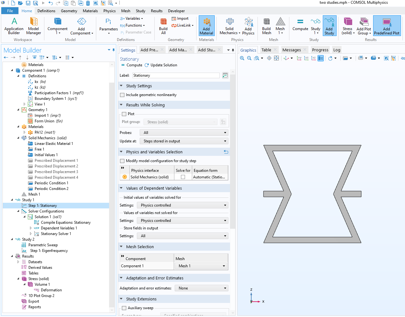

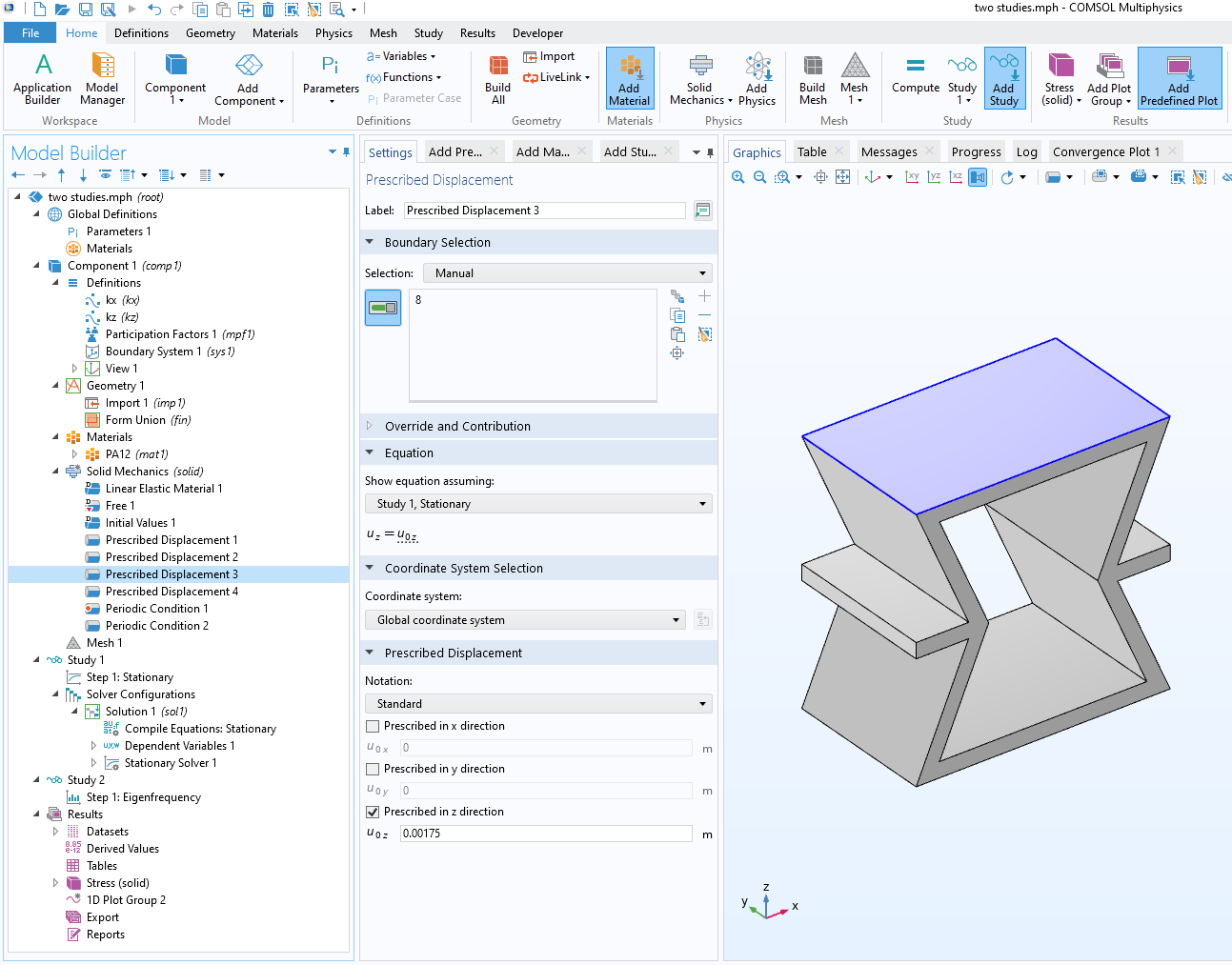

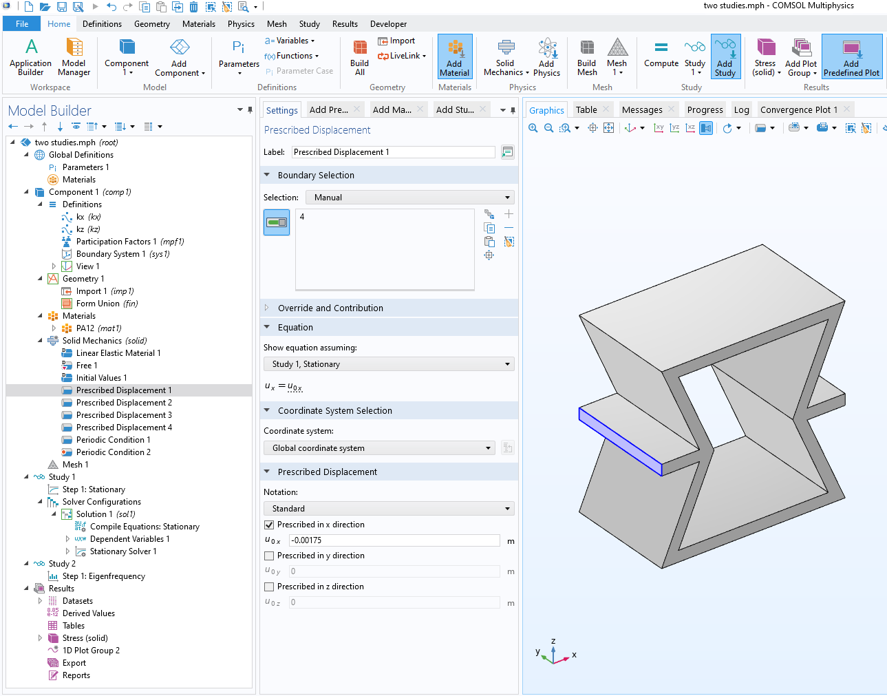

I am trying to define the dispersion curves of a periodic unit cell in COMSOL Multiphysics with prescribed displacements. I am using two separate studies:

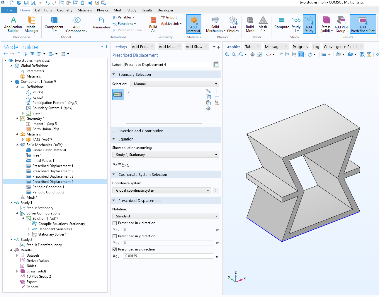

  • Study 1: Stationary, with prescribed displacements on the four edges of the unit cell
  • Study 2: Eigenfrequency.

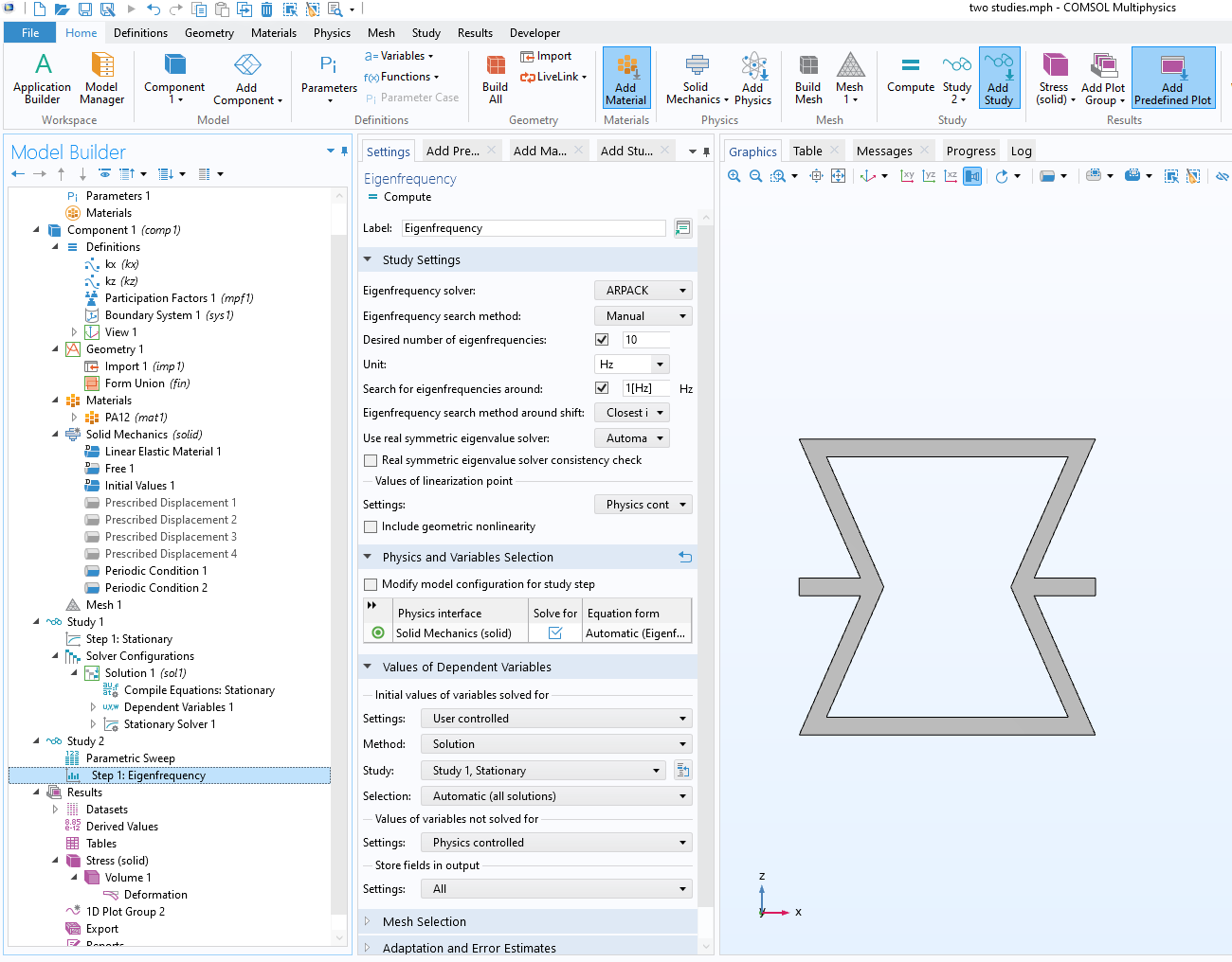

I intend to use the results of Study 1 as initial conditions for Study 2. I also conducted a different eigenfrequency study of the same unit cell, and the dispersion curves from Study 2 and this separate study are similar. This suggests that the results from Study 1 may not have been used as initial conditions for Study 2.
The following figures illustrate my setup. Could I be missing any setup errors?
Thank you in advance

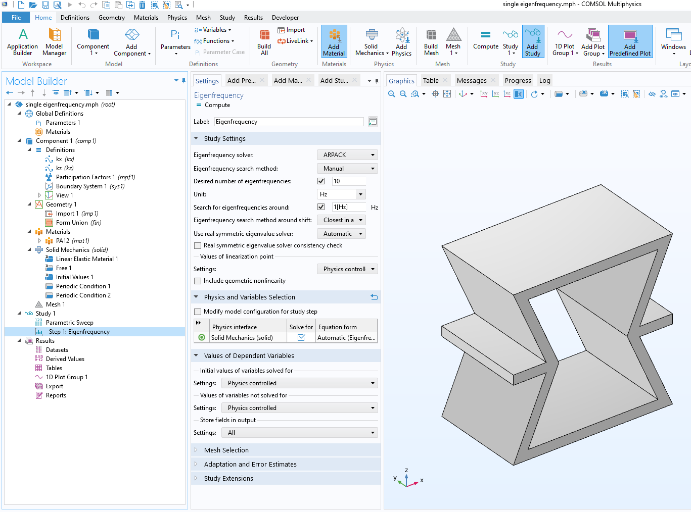

It looks like you have forgotten to include geometric nonlinearity in the eigenfrequency step. That is necessary in order to get a nonzero linearization point.

Dear Mr. Mr. Henrik Sönnerlind,
I forgot to include the geometric nonlinearity in the eigenfrequency step. Thank you so much for your valuable time and comments.
