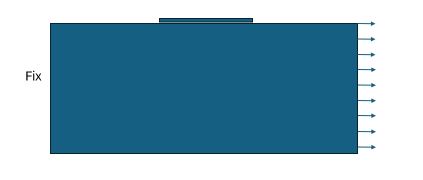

I am trying to set up a 3D contact adhesion problem between a substrate and a very thin layer, please see image. 3D is required because the depth (into the page) of the layer is smaller than that of the susbtrate.
I am able to generate correct results (congruent with theory) by simulating everything as solids, and adding a contact pair. The substrate acts as a source, and the bottom of the layer is the destination. I set up an adhesion node with user-defined stiffness both tangential and normal.
