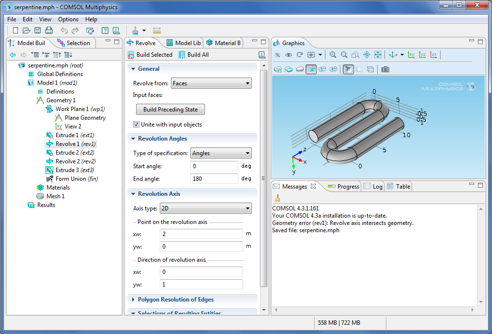

you can create a serpentine by extruding a face on a cylinder, alternated with a revolve operation (see screenshot).
Note that you can select a workplane or an existing face for these operators, a face is needed is this case.
Frank
