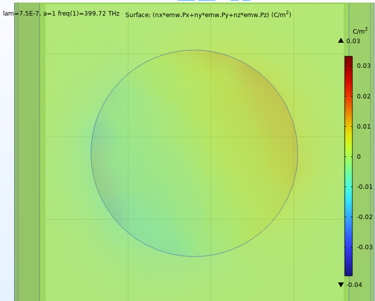

Fields computed in the frequency domain formulation are complex valued. Your plot of the normal component (that's the component of the vector along a surface normal, not to be confused with the "norm" of a vector!) of the polarization P is not a time-averaged value. Rather, it is simply a plot of the real-value part of a complex term. If you want to plot the magnitude of the P vector, plot emw.normP instead. If you want the magnitude of the specific vector component that you described in your post, plot abs( ) of the expression that you wrote.

Thank you for your precise and clear answer.
