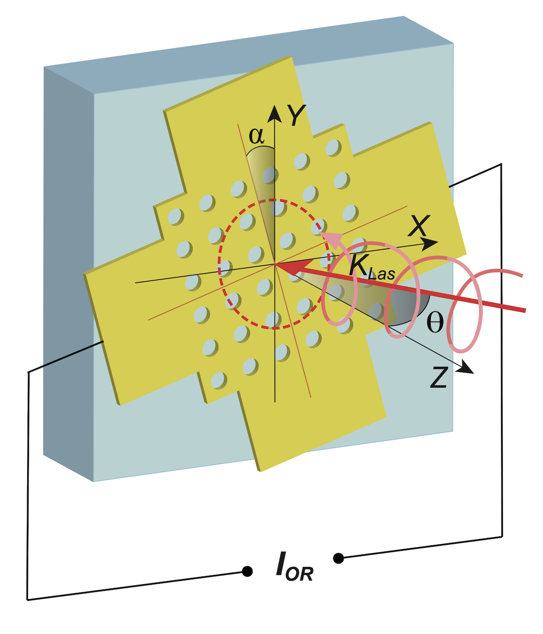

- I'm confused by your 3-component specification of the electric field. Do you have detailed pictures of your geometry, the desired incident wave-vector (k) direction, and your coordinate system?
1. You might want to post your .mph file to the forum.
2. I'm confused by your 3-component specification of the electric field. Do you have detailed pictures of your geometry, the desired incident wave-vector (k) direction, and your coordinate system?

My .mph file is too big but this is my structure.

Well, I don't have the wave optics module, but now I can see why you want to use periodic ports (which will model an infinite array -- this may differ somewhat in behavior from the finite array in the earlier picture that you posted). Anyway, it helps the forum that you posted the model. I encourage those who have the wave optics module to take a look at your file and to offer suggestions.
Well, I don't have the wave optics module, but now I can see why you want to use periodic ports (which will model an *infinite* array -- this may differ somewhat in behavior from the finite array in the earlier picture that you posted). Anyway, it helps the forum that you posted the model. I encourage those who have the wave optics module to take a look at your file and to offer suggestions.
