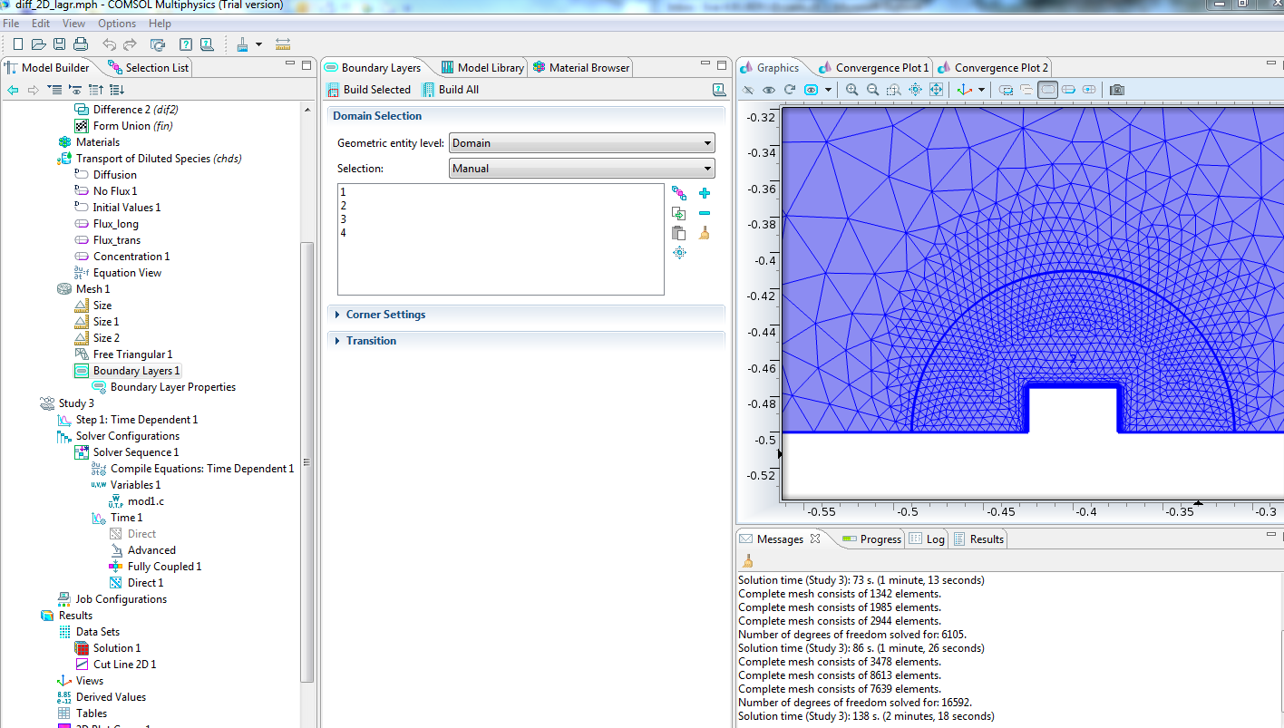

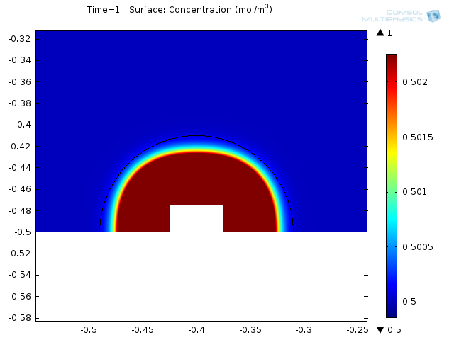

Posted: 1 decade ago 30.10.2012, 06:48 GMT-4
if you want, have a look at this file.
thx in advance.
if you want, have a look at this file. thx in advance.
Posted: 1 decade ago 30.10.2012, 08:40 GMT-4
you have also the level set and phase method, this is not my domain really so I'm not the best to give hints here.
From your model, I have 2 comments: 1) your concetration is not defined on any boundary, I assume its the three small bottom squares with influx.
2) when I look at the results, I see clearly the mesh paterns, which means that you have a far too coarse mesh in the region of the high concetration. try to maually refine your mesh by selecting the high concentration region and mesh the edges manually extremely fine
You could aslo add a half a circle around the three domains some 3-5times the ir dimension away, and select this local region to get far finer mesh therein
