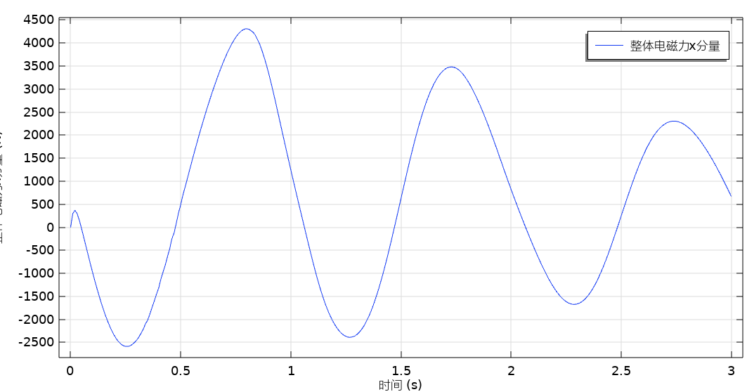

I use a magnetic field to simulate a two-dimensional linear motor. The value of the traction force in the simulation results fluctuates around 0. What could be the reason for this?

The problem is that your frequency f changes too fast. If a linear motor with magnets, it is a synchronous machine. It has no starting torque. Try increasing the frequency in the winding smoothly.
