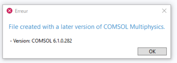

Hi, Is that possible to open un file vesion 5.6 in version 6.1? beacuse when I tray to opent it the application refused.

Hi Abubaker,
It's possible to open an MPH file created using COMSOL Multiphysics version 5.6 in version 6.1, but not the other way around. If you have trouble importing model files from earlier versions in COMSOL Multiphysics 6.1, please contact our technical support team. The error message, however, indicates that you are trying to import an MPH file from a newer version in a older version, which isn't possible.
Best regards, Magnus
