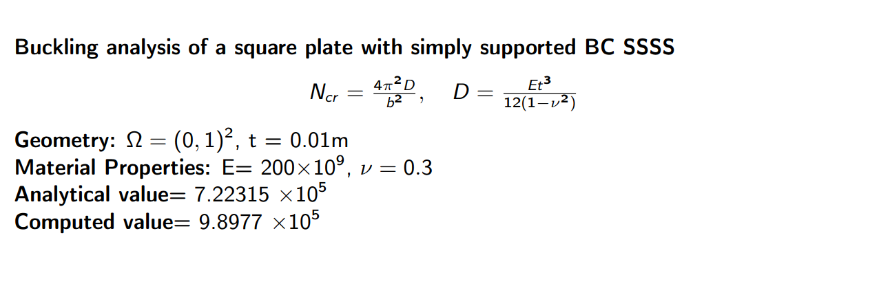

Hi, I want to find the critical load of a plate with simply supported boundary conditions. And compare with analytical results. But I did not get the correct value. You can see further detail in the screenshot(Buckling_Plate_SSSS.png). The comsol file is also attached. Kindly tell me how I can fix this error.

Plot the stresses (for example principal stress vectors) from the preload case to check your boundary conditions. You will, most certainly, spot the problem there.
